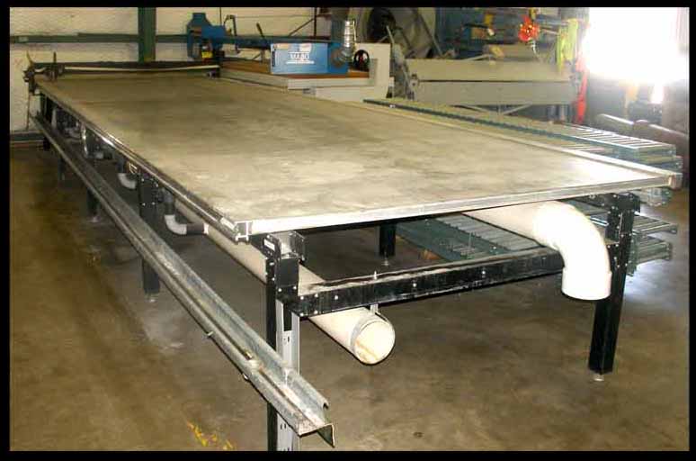

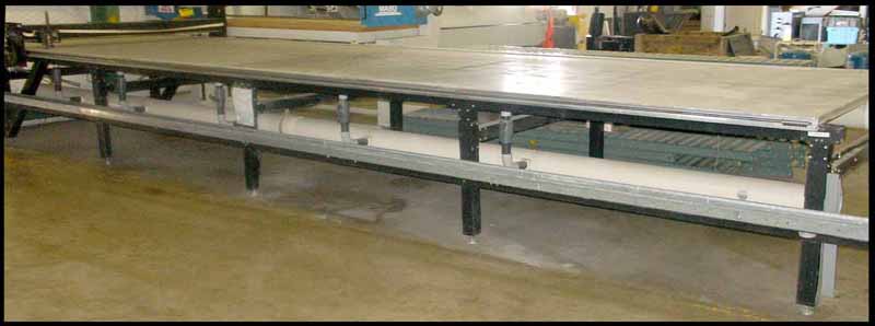

here's the gantry table. i bought it today! i am psyched. there are a lot of 2.2m chinese dual dx5 printers out there too that may do the trick. i just want the thing to wake up and print. it will be put through enough already being gutted and strapped to a table.

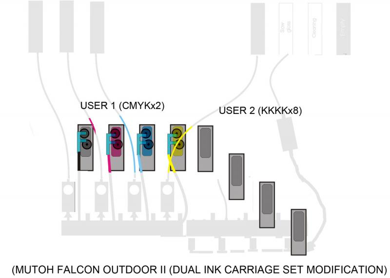

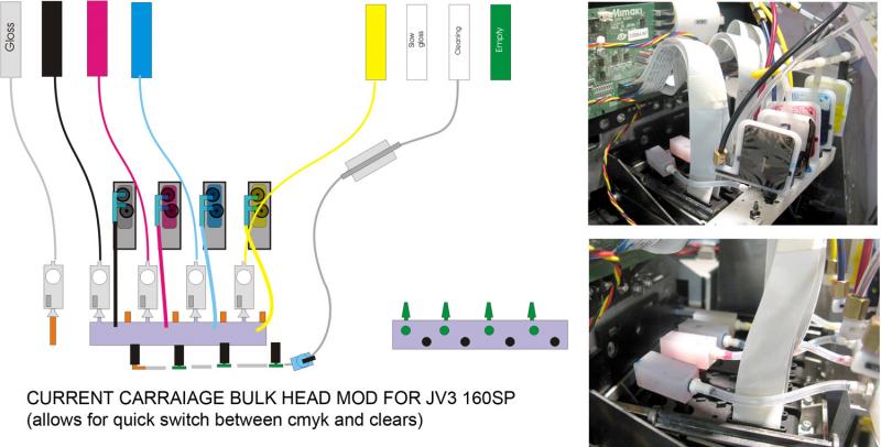

i came up with an option that might be possible. today i spoke in length with a RIP engineer and he helped me understand what code is difficult to hack and vice versa.
attached is a pic of my current ink train set up. (mimaki jv3 160sp)
the second rendering is what might be possible if i could do a "user 2" (second ink set option) that i've read about occasionally in some mutoh pdfs. but i'm just not clear how dual inksets are accomplished. the user manuals don't seem to mention it. or maybe i just don't have the right model's manuals in which to read about it.
the inks require very high heat to cure so i could oddly skip the capping station mechanics. but i would build a manual syringe based offset capping station (as in "stick it" on by hand) for priming the heads.
of course i'd need a RIP engineer to modify the rip and firmware in order to multiply the K channel and offset the rasterization across a different distance plus quadruple the x distance per pass. but at least after building the flatbed knowing it's currently too slow for future production, i'd have this option in my back pocket to speed things up. the printer would do 1200-1600 sfph 1 bit printing nicely.
so, my question is, what models and with those models, how is the dual ink set up in the firmware?

jhanson
You're going to need an 8-head machine, either a Falcon II Indoor 87, Falcon II Outdoor 87, or basically any other derivative model with 8 print heads. Then you'll need to run the Falcon II Indoor firmware (latest is 1.31) and set it to the dual inkset mode.
Once that's done, it's just a matter of determining which slots correspond to which heads. The slots are supposed to be loaded (Set 1) K C M Y (Set 2) Y M C K for the dual ink option on the Falcon II Indoor. However, the ink lines going to the heads on those machines are run in symmetry, leading to this channel order -- 2 colors per head:
(1KY) (1CM) (1MC) (1YK) (2KY) (2CM) (2MC) (2YK)
Where things get really fun is that the engineers played around with different ink line routings for the various derivative printers. The eco-solvent Outdoor models did away with the symmetric load. The textile models (Viper) screwed up the symmetry even more. So if you get a non-indoor model, you'll have to play with the plumbing to make it match what the firmware expects.
Basically, you're going to have to have the first 4 heads loaded identically to the Falcon II diagram above for CMYK printing, which may give you headaches with cross-contamination if your pumps or wipers aren't working normally. Then to stagger the remaining heads, you're going to have to do some major surgery to that side of the head carriage; since all heads will have the same solution loaded you can plumb those lines straight through but the electronic firing order will get interesting.
Hope that helps.

does it ever. i feel like i'm googling mutoh with the replies i'm getting. thank you!
so falcon outdoor II's (very common. a few 87's out there currently. doable. but there will be an after noon of cursing the mutoh gods. that layout will kill the f-style manifolds. one damper per head will be impossible.).

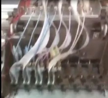

that said, i've found one possible chinese contender (there are a few 2.1m chinese printers all of which after research look to be okay to iffy, namely the UD2112LA's).
but there is one chinese printer by wit-color (the ultra 9000) that gets really great reviews. but it's not cheap (so to speak). it's about $11,000 for what most chinese are charging $7500. they have a 2.2m dual dx5 that prints some amazing 1 pass coverage. and even FLAAR admits that wit-color makes finely constructed printers. it would though be a shame to tear apart a brand new $11k printer. but, this thing would make a sweet solvent flatbed.
check it out.
1 pass (700 sfph 360 x 720))
http://www.youtube.com/watch?v=6RHt4jlRPaA&feature=player_embedded
fine text
http://video.yandex.ru/users/mfrfh/view/1/#hq
http://video.yandex.ru/users/mfrfh/view/2#hq
note that it's a big printer (like a jv5)? in the wit-color literature, they mention that these ultra9000's are built for future field upgradable speed. so as soon as the boards and demand show up for 3 and 4 head printers this chassis is designed to allow for four heads. that's pretty ambitious engineering.
