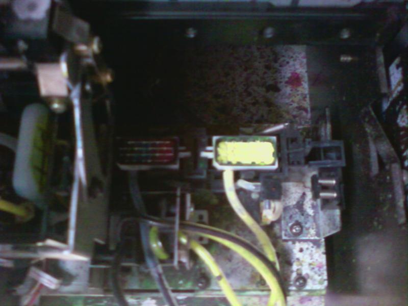

I was wondering if you guys could help me with an ink contamination issue?? I have a versacamm sp 300v I've done a search on it, but I'd like a fresh take on it?
Problem is...usually every morning when when i get to the office and start to do some printing for the day I have ink contamination where the yellow is orange or worse (where magenta is bleeding back up the print head line) or my cyan is black and the actually line is also black....I either have to suck out the line through the cap tops (which pulls black and cyan....or yellow and magenta) or print alot of yellow and cyan to get the ink back to normal. I've replaced the cap tops about 4-5 months ago...it slowed it down a litlle, but not much...The machine is a 2006 model and the factory pump has been replaced....Only thing I can think of is the dampers...which are the original dampers that came on it????? Could that be it??
Oh...also if this helps sometimes even if I have printed all day sometimes when the last print has finished...and i begin to start a new one directly after the last one....the first 5 or six inches of the new print the ink is contaminated???? Is the print heads not in line with the cap tops after cleaning from the previous print...causing the 2 inks to mix??? Because 2 colors share the same print head and cap top??? What you guys thinK??? Thanks
