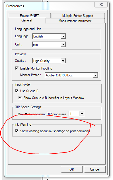

When you go to send a job in RVW it should say something along the lines of
'You may not have enough cyan to complete this job, do you want to continue?', this means you are low on that colour, then you can make a call as to the size of the job and the amount of ink...i.e. if I was printing 1m of yellow stickers, going to be fine...if I was printing a 6m blue banner...I may want to change my cartridge so it doesn't run out mid print.
Huh, I don't think I got a warning like that when I sent my job. When I sent the print the ink levels looked like enough to get the job done, but the magenta ran out little after midway through the job.
Do you keep VersaWorks up to date? From memory this feature was introduced several years ago (4-5) so if you're still on an older version that may be why you haven't seen the warning before print.
We used to see it all the time when the inks were nearly out, so it was a good warning to swap the tank out before a big print.
There's also an option that must be selected in the preferences, have a look?
Yep, latest version and that option is checked, must have thought it had enough or I just missed it entirely.
