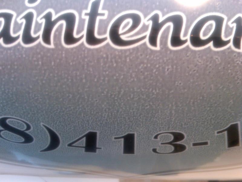

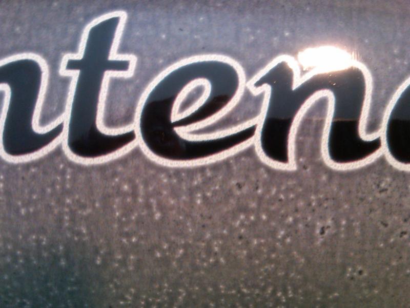

I am having a problem with ink pooling and coagulating on my prints.
I am using Oracal 3651. Whenever I have a gradient or screened image to print I am having this problem.
I have been playing around with the heat setting for the rear heater but not much luck.
Anyone have any suggestions?

Here are pics of the problem I am having.
Not the best (from my blackberry) but should show what I mean.

HaroldDesign
I run Onyx on a Mutoh 1604. I've used substrates with profiles meant for the particular substrate and printer and still ended up building my own. It may not be the problem you're having, but I've had the same problem with various pressure sensitives and they went away when I bought an X-rite and started building my own profiles. They're expensive, but are a HUGE help and worth every penny!
I am sure that that is a huge help especially for color matching issues but my issue is not color matching it's the ink drying on the media (I think).
HaroldDesign
Have you tried lowering the ink limit?... or maybe the black is built 100% of CMYK and laying down enough to puddle.
Arstron
What are your heater settings at? Also whats the name of the profile you are using exactly? I am going to lean more towards a heater issue. I currently am running mine at 30 preheater, 35 platten, 50 for the dryer/post heater.
randya
this looks like media to me, heat may help.
Try wiping it with denatured alcohol and let it dry just before printing.
Thanks for all the suggestions guys, I will play around with it tomorrow and post my findings. I have been playing around with the heat settings all day. I tried everything from 50 to 20 adjusting the front and back heaters and always the same problem.
