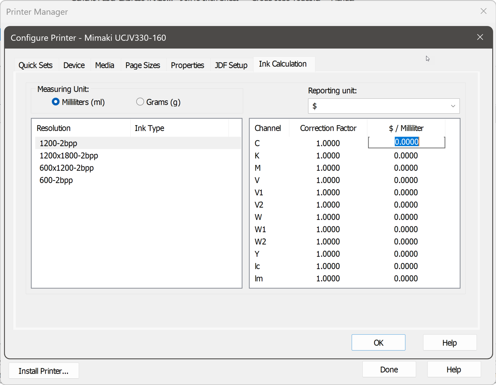

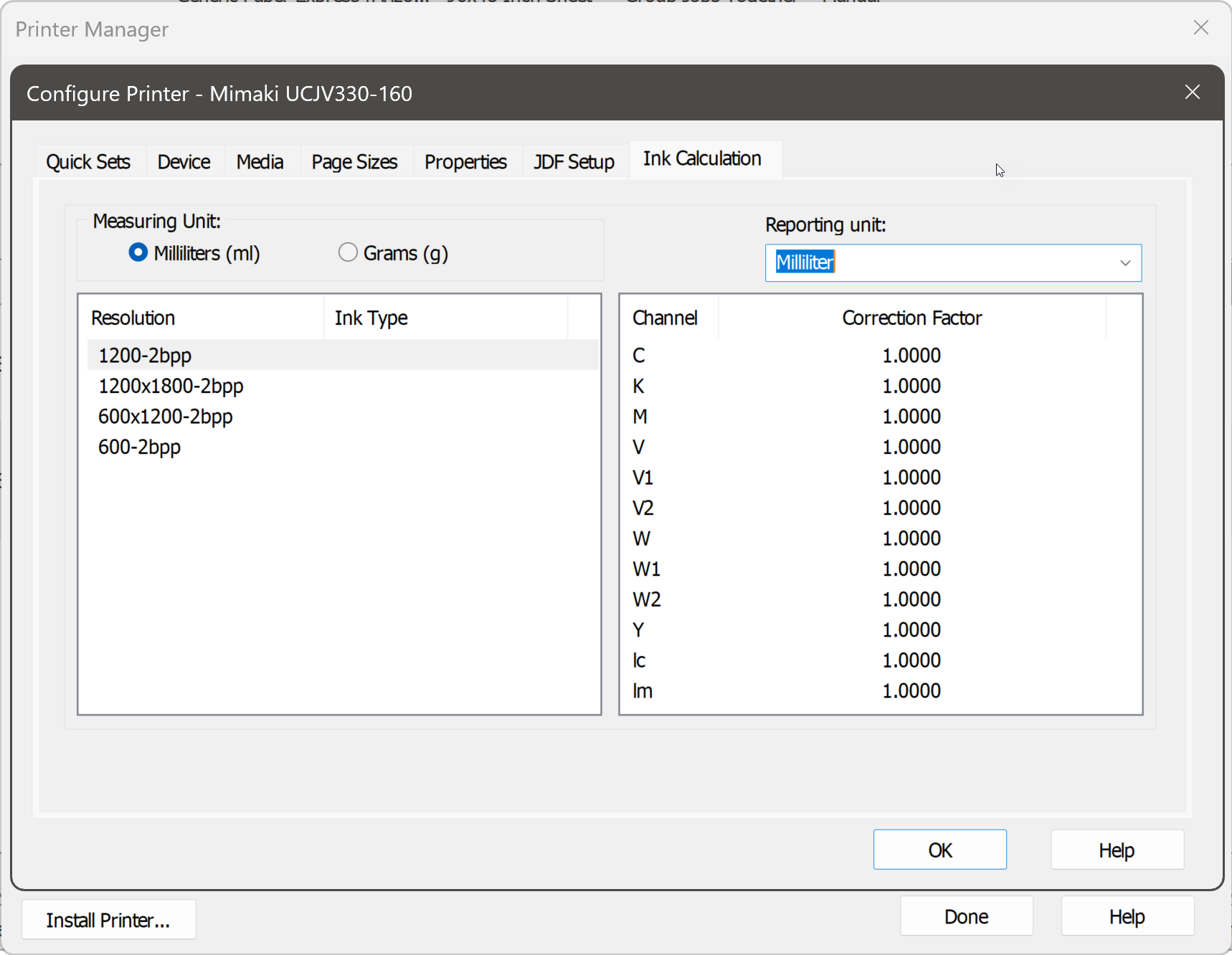

If you have enabled ink cost calculation within the RIP Queue, it will count all of the dots that were ripped into the file. Ink drops are measured in picolitres. It will count all of the dots and associate a cost based on how you have established your ink costing. In Manage Printers, you can establish those settings. I believe that the ink droplet by default is set to 4 pL. The correction factor will increase or decrease the droplet size. Set your ink cost for that channel by entering the dollar amount per milliliter.

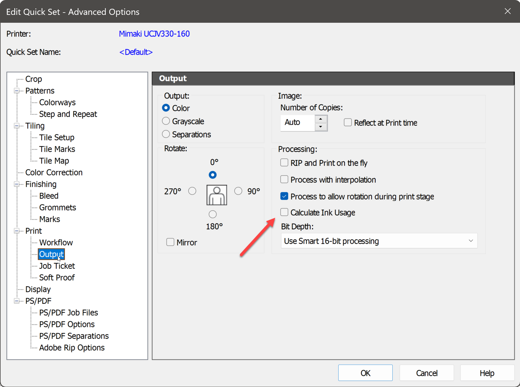

In the Quickset, you must enable ink calculation so that it will count the dots after it is ripped. Be aware that this will increase rip time since it needs to count every single dot for each channel after the RIP file is established. This is found in the advanced options under Output.

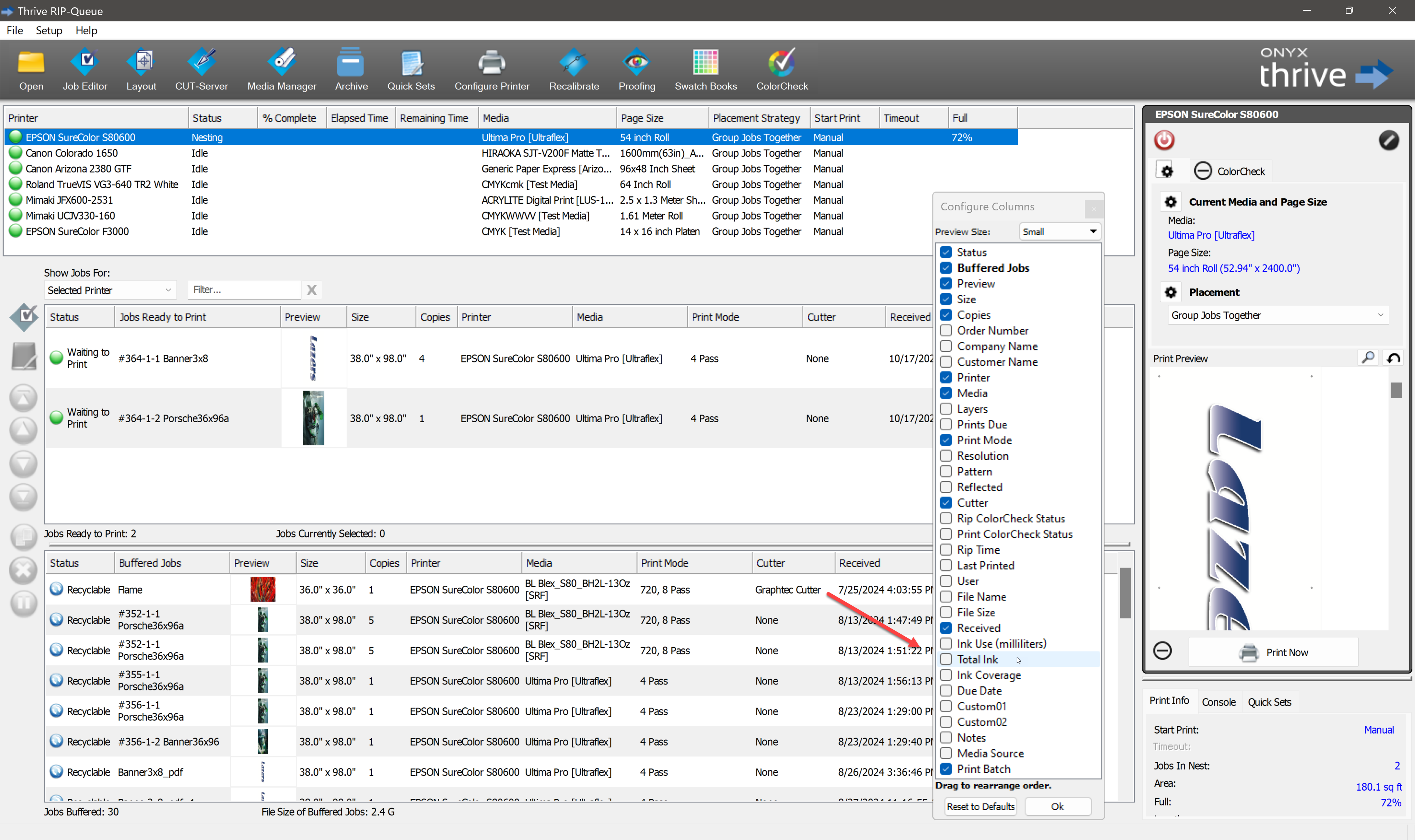

After this is set, you will see the amount of ink in either the Active or Inactive Queue in RIP Queue. This may need to be enabled by right clicking the menu bar and placing a check next to Total Ink.
