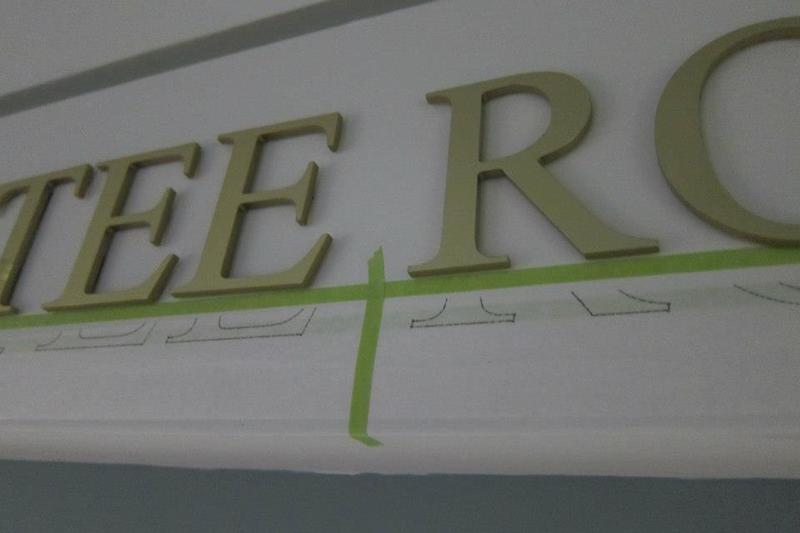

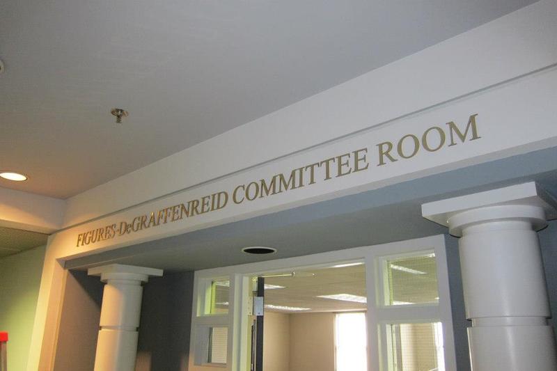

here you go, i posted this on my facebook page cause some one asked how the hell we get stuff straight
Produce the sentence on your plotter with an outline only on paper. Get yourself a pounce wheel and pounce the important areas. The wheel costs a few dollars. Tape it to the wall with blue painter's tape, put your powder on and you're good to go. Save the pattern, in case they want another site done.

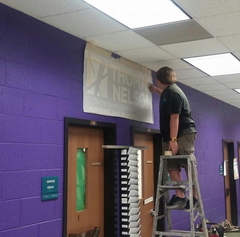

I put the VHB tape on the letters. I then stick these letters onto a clear liner that is over top of my pattern. Then I transfer tape them in place. Go to job site and line up on wall like vinyl. Tape top and pull liner out from behind and stick to wall. Pic below is after liner was pulled.
These letters were 1/2'' pvc with brushed metal face.
thats pretty ingenious thanks

Yes. All the work is done in the shop. You get to the job and if the customer knows exactly where they want it, you are done in minutes and the customer is amazed. I've been doing it like this for years.
I think I like this the best.
So would all I have to do is print (are use plotter pen) a few inches of the bottom for reference and then just make sure the tape line is straight and pretty much eye it up for spacing with the guide I printed?
visual800
its just that easy sir
