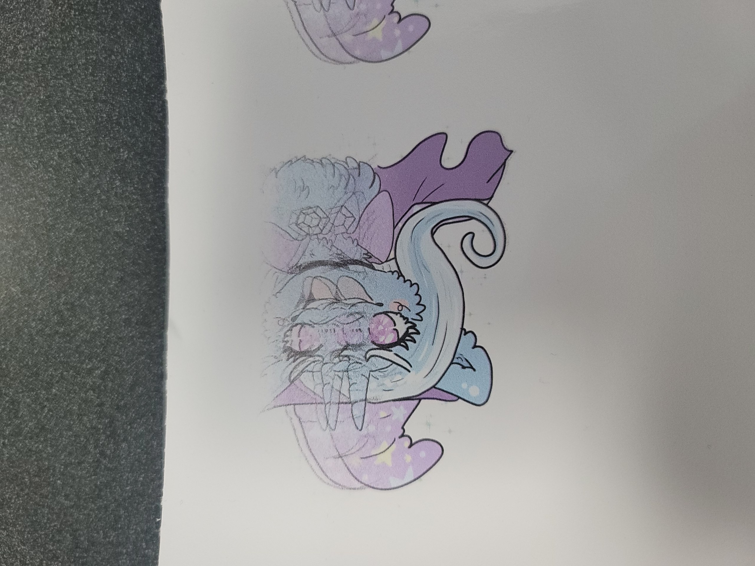

ok got everything working but every few prints I get a double image and I can't seem to find a reason I am using sai 10.5
yonu
You're kind of right I actually figured it out and it was something I didn't think about The PF encoder wheel went bad it literally looked like somebody had chewed it up
