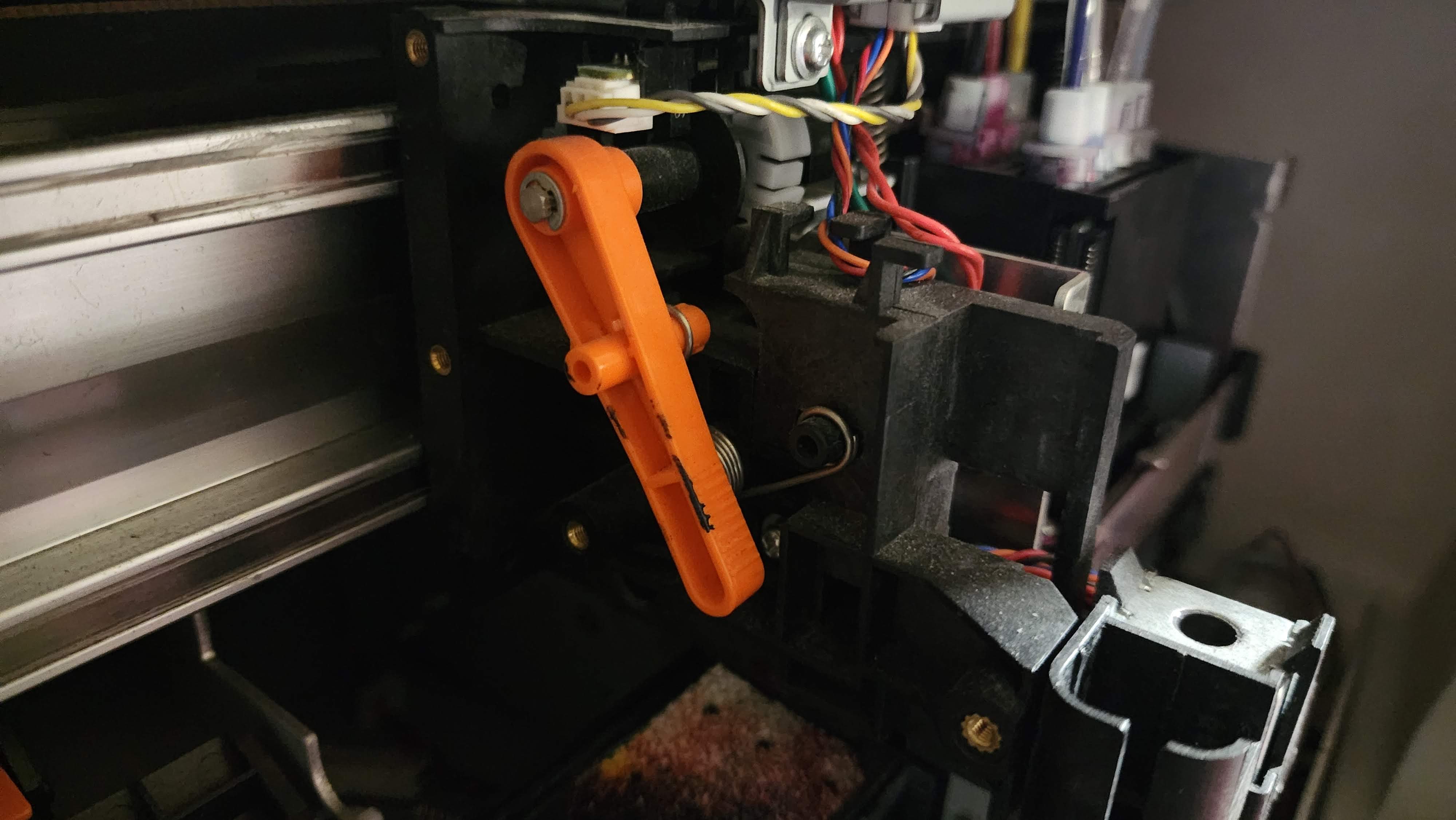

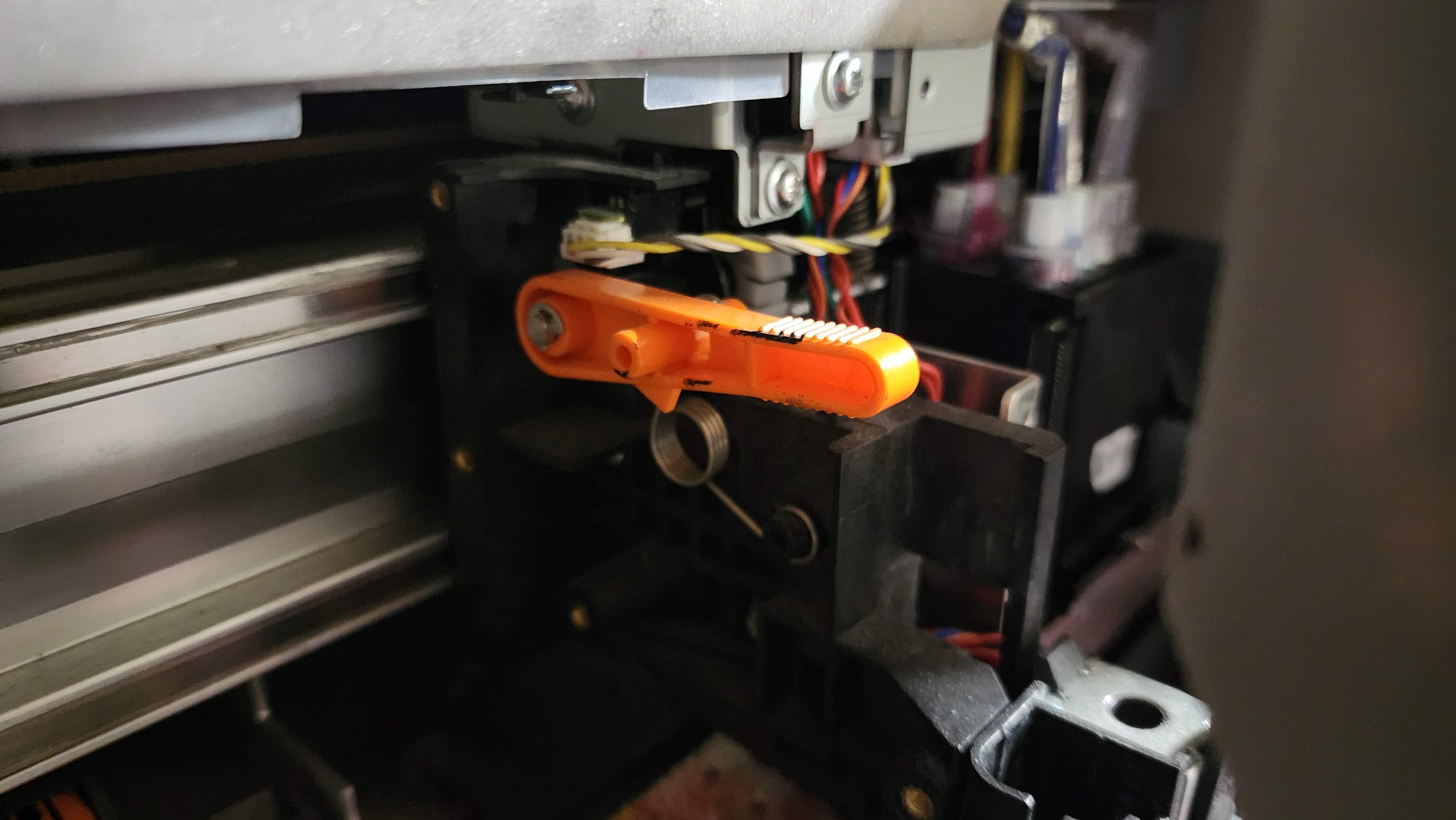

There is an orange lever on the left side of the carriage. When it is pointing down it is in the low head height, when it is pointing straight out it is in the high head height. The only other height adjustment is service related and it is only changed if the carriage isn't within spec.
Low Head Height:
High Head Height:
