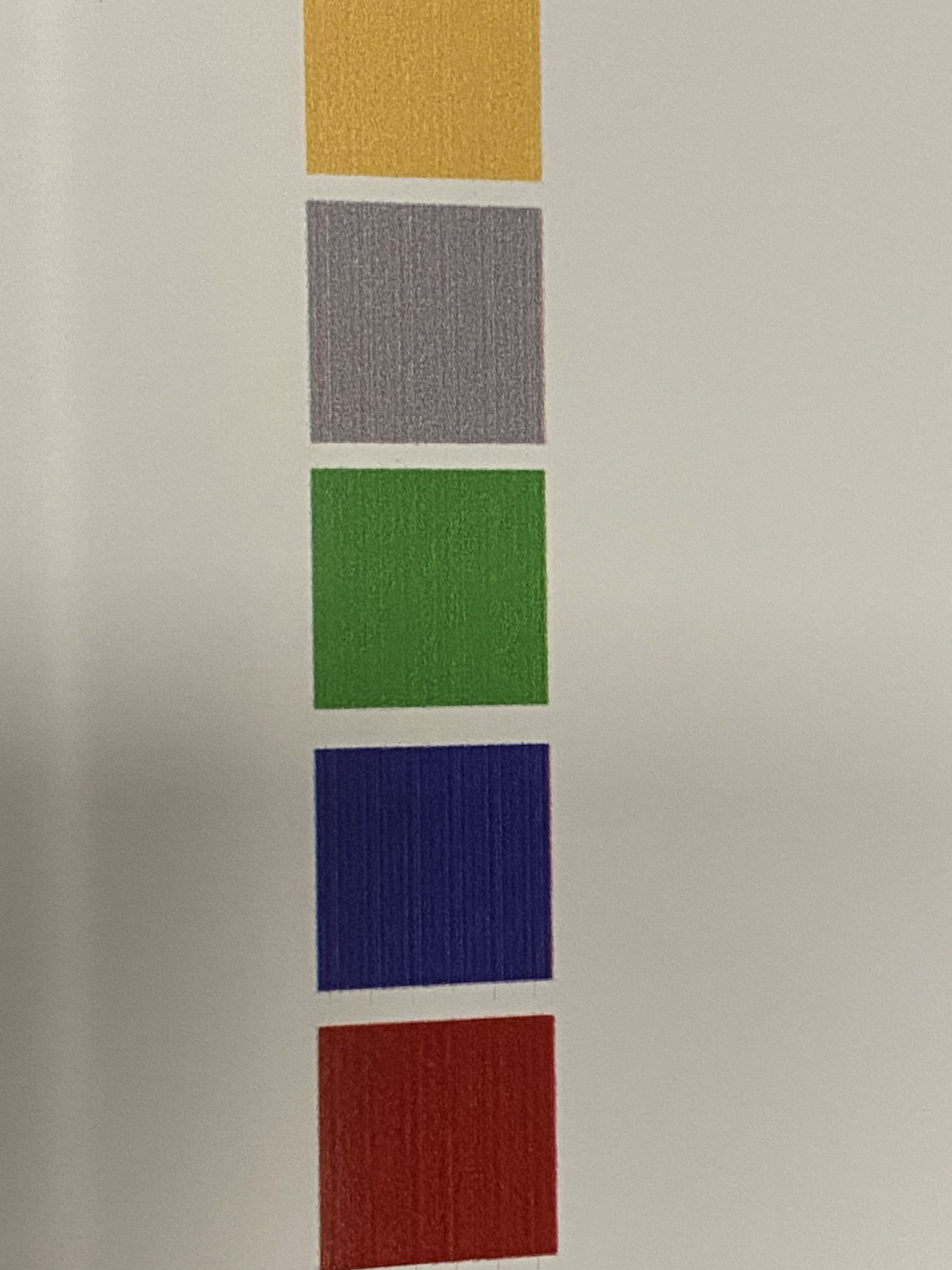

Im having a hard time getting a good print with the 1304 eco ink. We mainly do dye sub printing, but odd times we need to print on digital heat transfer or make small stickers. Decided to get something used for the rare times I need it. I attached pictures, its very grainy and looks awful.

netsol
You probably need to create your own profiles,
At the risk of repeating myself, a profile compensates for the characteristics of your ink and media, as well as your machine. You are covered on two fronts, with downloaded profiles.
The only way to compensate for your machine is to do the work & build your own profiles, if your machine is not perfect, or at least typical.
