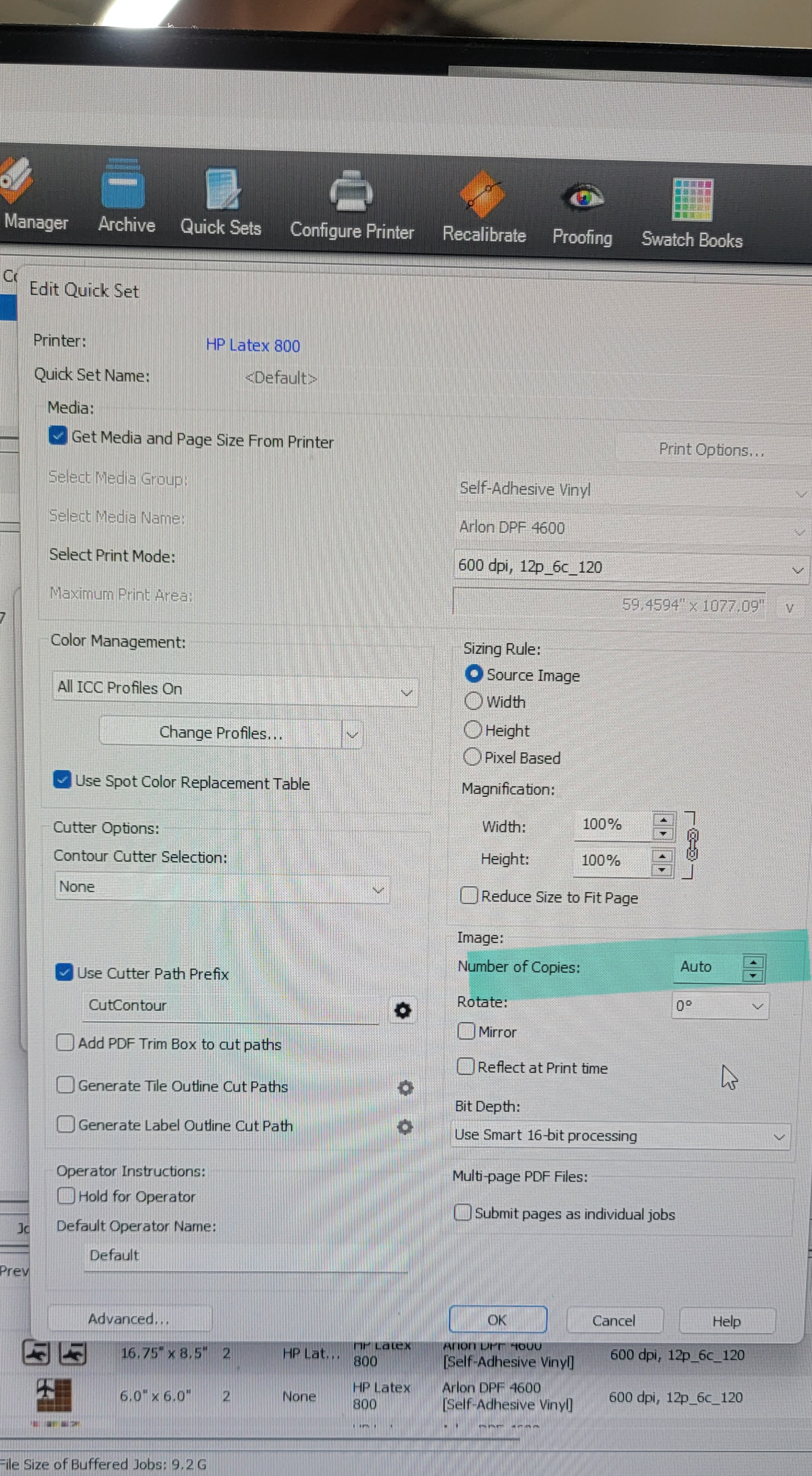

On your Onyx. Go to the top to where it shows (Quick Sets) Open that. Go to (edit) If its default open it.
Look under the Image: section and make sure it's set at Auto!
That way when you print it you choose how many on the other panel.
Hope that helps!
