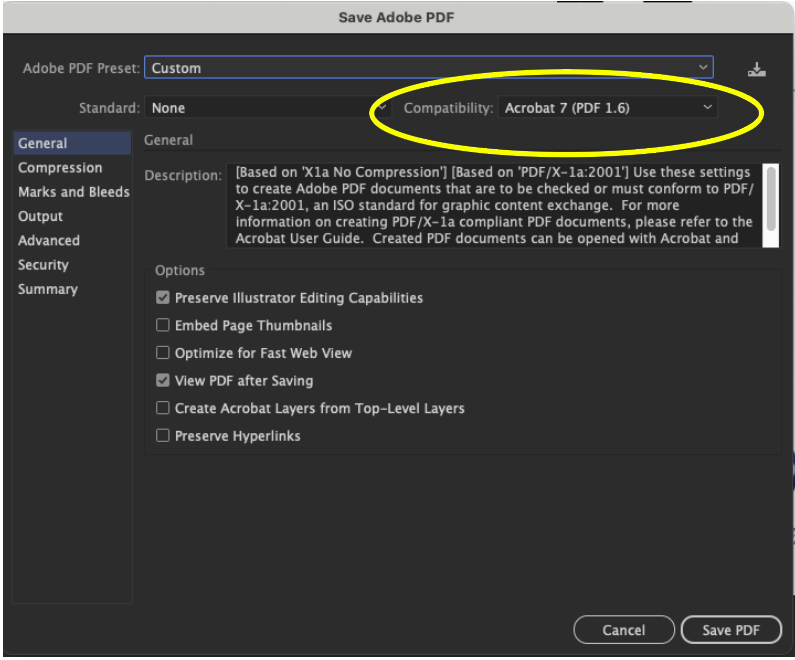

The default setting on Compatibility is Acrobat 5 (1.4). Change it to Acrobat 7 (PDF 1.6).

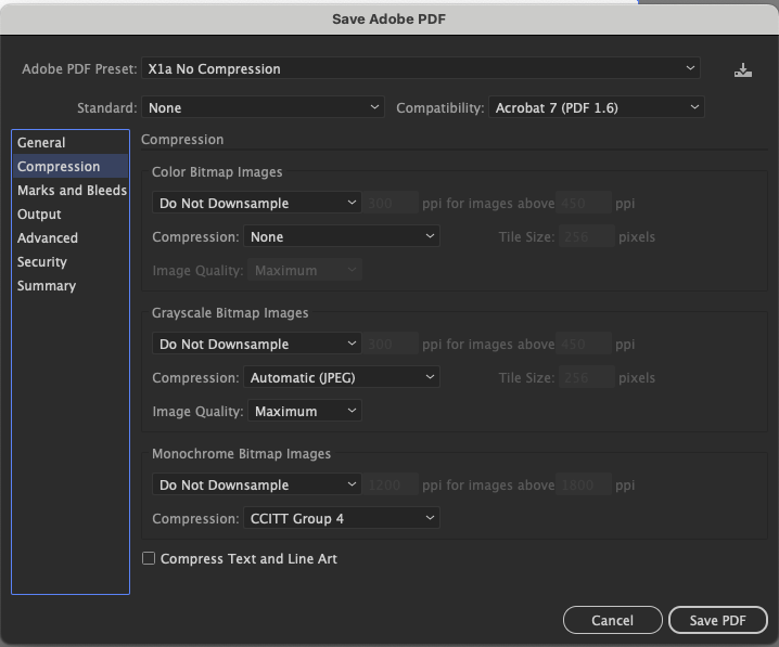

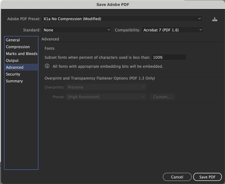

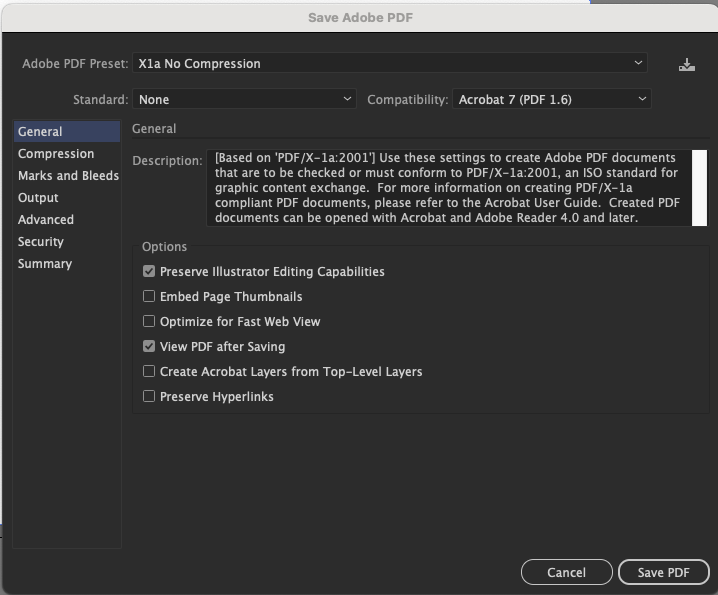

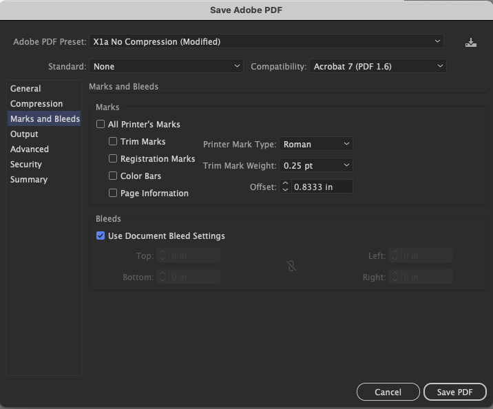

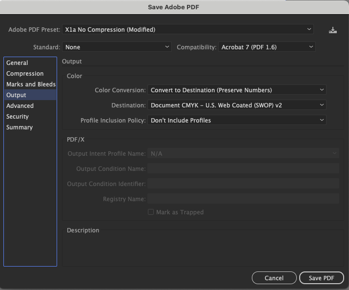

With the dimensions you're spec'ing I'm guessing you are already working with large canvas. I often do our exhibit murals at full size without issue. I created a "save as PDF" preference. SC's of each of those settings below.
