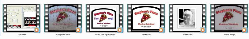

i just found all these quicktime tutorials about how to use white ink in rasterlink if anyone is interested.

pm'd you a few days back. these videos are on a spare drive but i can look them up in a day or so. maybe upload them?
