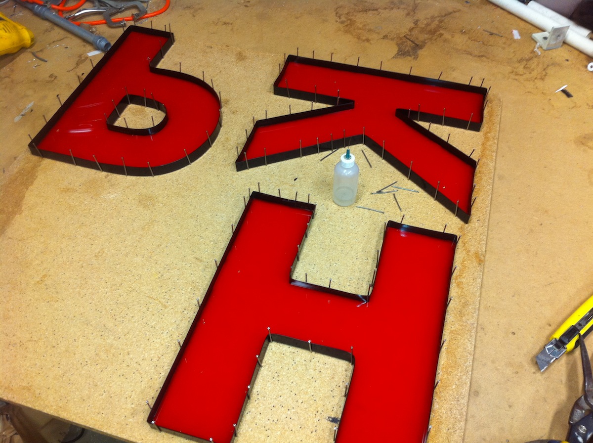

I believe that many trim-capped faces fall apart early from poor gluing. I have always glued the trim in two steps. First with water-thin Weldon in a syringe to hold the acrylic in place. Then a substantial bead of Weldon No. 16 when the thin stuff dries.

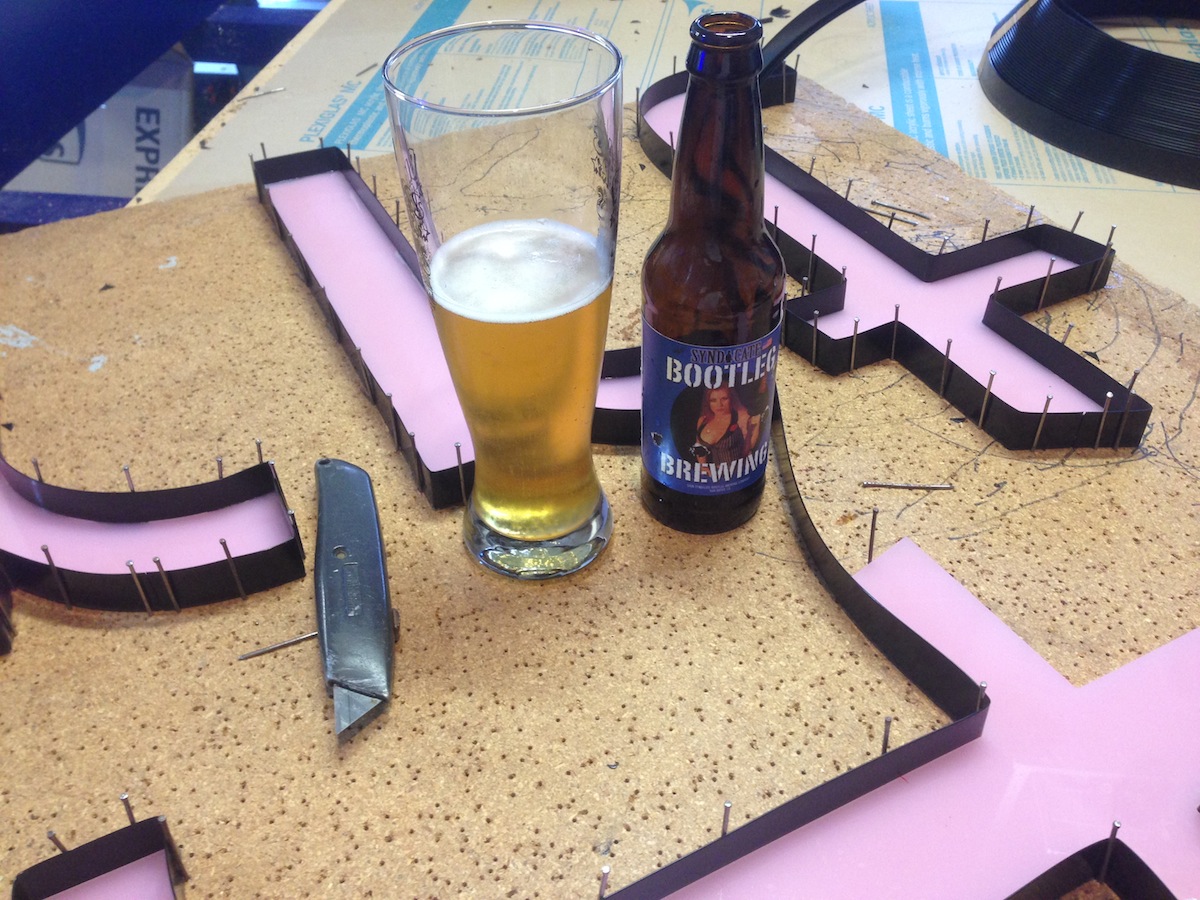

kgirl
You put the Plasco Channel Letter Trim Cap seam at the top of a letter....and at the bottom for the inside of an "O"......

And for those who are new at trim-capping, if you use the hammer and nail method, expect sore fingers at the end of a day of trim-capping. That is the purpose, I am sure, of the bottle of ale in kgirl's photo. It's for soothing sore fingers. But it must be ice cold.

A little clear silicone wiped into the seam would eliminate any water penetration....but we never worried about it. I learned signbrads way, glue in place and then add another bead for good measure.
