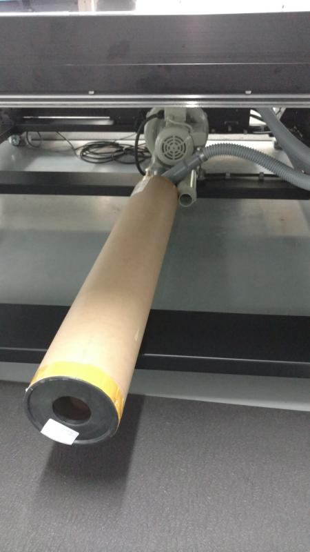

This is cheap but it works very well! Thanks to Larry Shaw for making it for me while he doing our training.

Great idea! No issues with vacuum pressure or extra work on the motor?
This thing does need a muffler right out of the box. Man, is it loud...

Not so far and it makes so much difference in the noise! Vacuum pressure is as strong as ever.

We just set up 2 JFX200-2513's and man they are loud. I looked at your pic and was wondering what he had put inside the tube? Because I really need to make a couple of these. Info would be greatly appreciated.

We actually used some of the styrofoam packing that came with our machine. That is about it! Every now and then I pull it off to remind myself how much it dampens the noise. lol Good luck!

After seeing this I made one this morning and it makes a huge difference in being able to hear anything going on in my shop.
