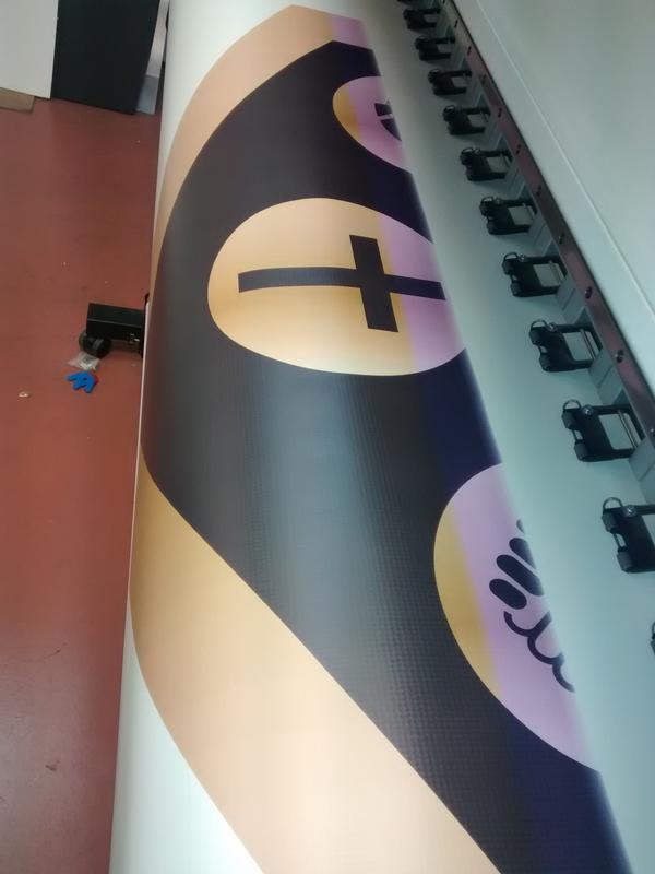

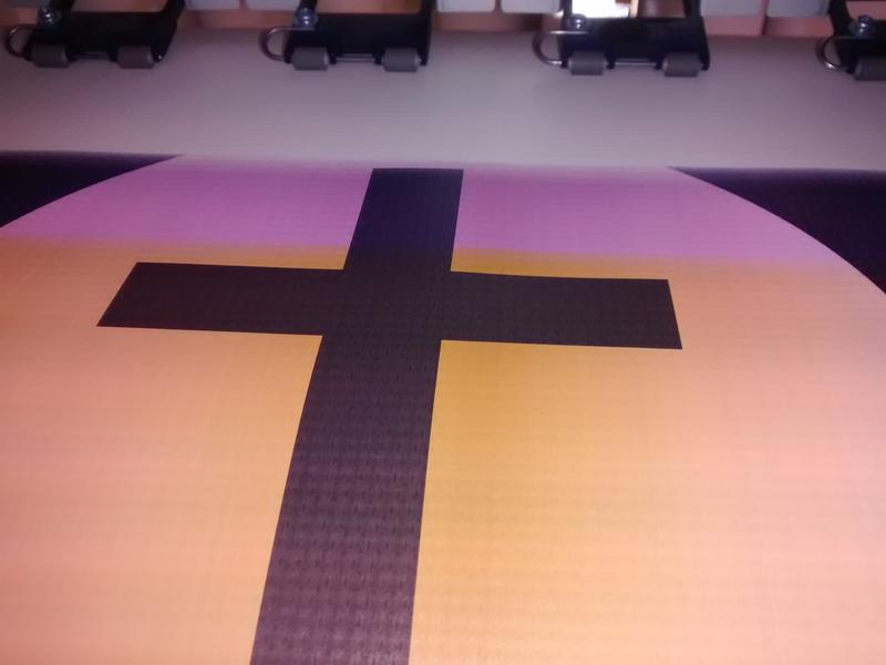

Yesterday I was printing on Perforated media on our JV33-160, in the middle of the print the yellow and one of the light cyan dropped out (we use 8 cartridge SS21 ink). Test print revealed the drop out so I ran a hard clean and then test printed again, both colors came back perfectly. I restarted the print and it happened again. I inspected the print head thinking possibly something was obstructing it, but found nothing. Has anyone had anything similar to this happen? I ran a full print on non-perforated media (Oracal 3951) today and everything was fine, although I am hesitant to let anything go over night now.

Do you have a pic... color drop out in different shapes, positions can be caused by different issues.

I had the exact same issue a couple of years ago and it turned out to be a slight leak in the capping station. I would replace the capping station and dampers with oem parts.
