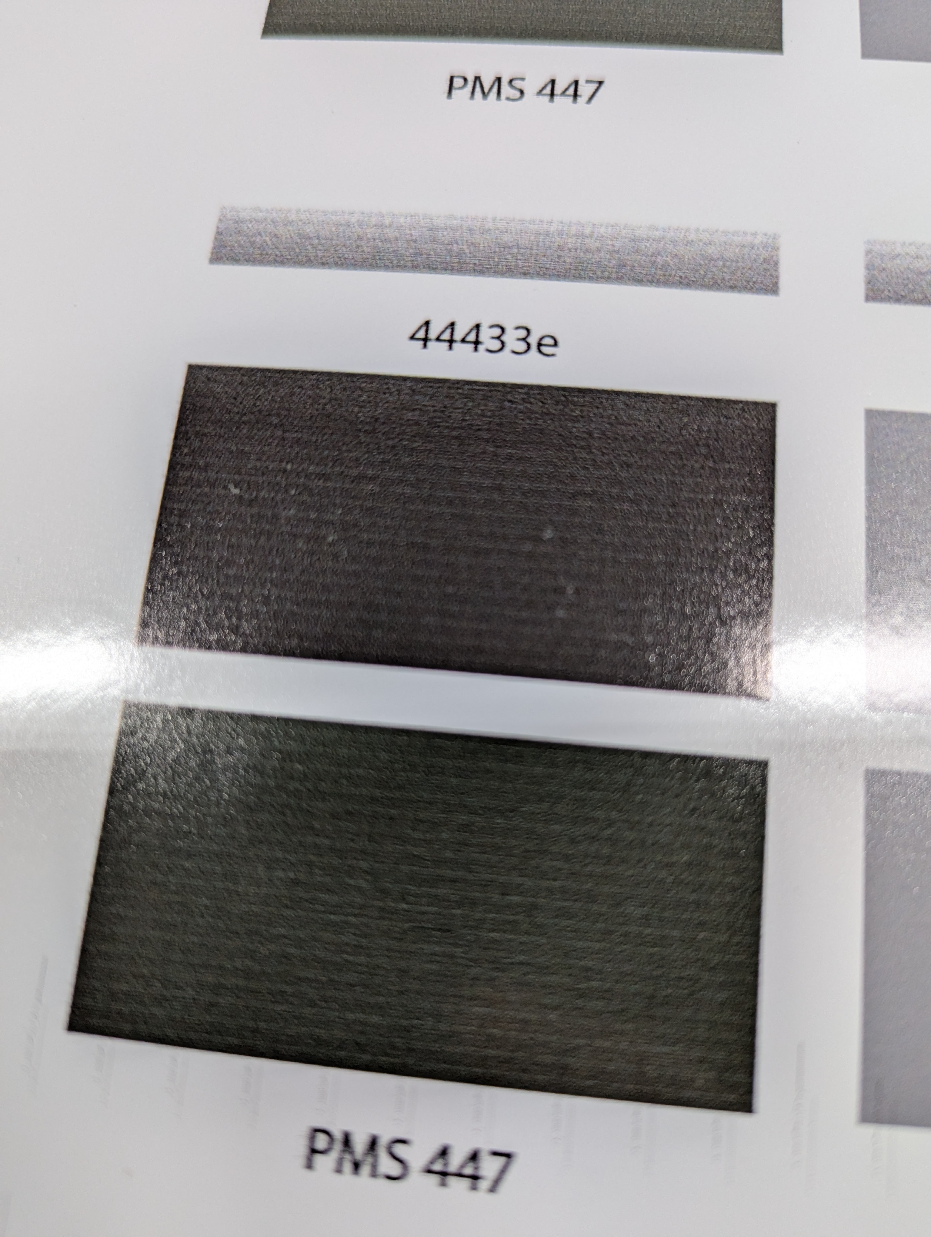

I'm having an issue with some black nozzles on my JV33-160. I replaced the head about 3 years ago. I did have a couple of head strikes in that time. It seems like the black was the only color affected by it. I thought I would get the nozzles back, but I didn't and it's getting worse now. Any kind of grey has thin streaks in the print. Only 100% rich black prints a solid color and even still you can see it at the right angle.

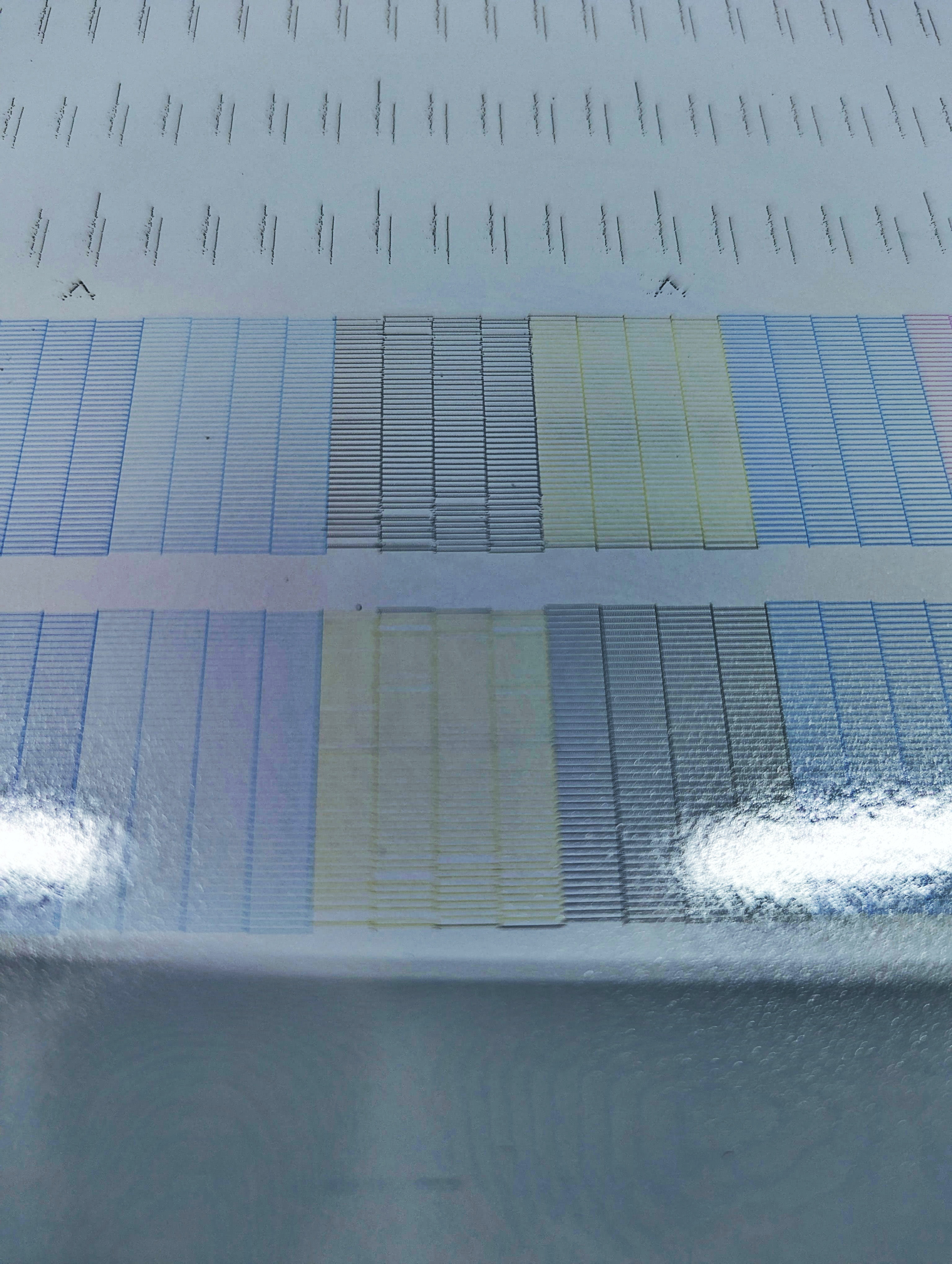

I swapped the dampers and confirmed the failed test print with yellow. I should have used cyan, but I edited the photo so you can kind of see the lost nozzles in the yellow when it's in the black position. Everything else is perfect except that black channel. The grunge in the photo is just from the edit to make the yellow more visible.

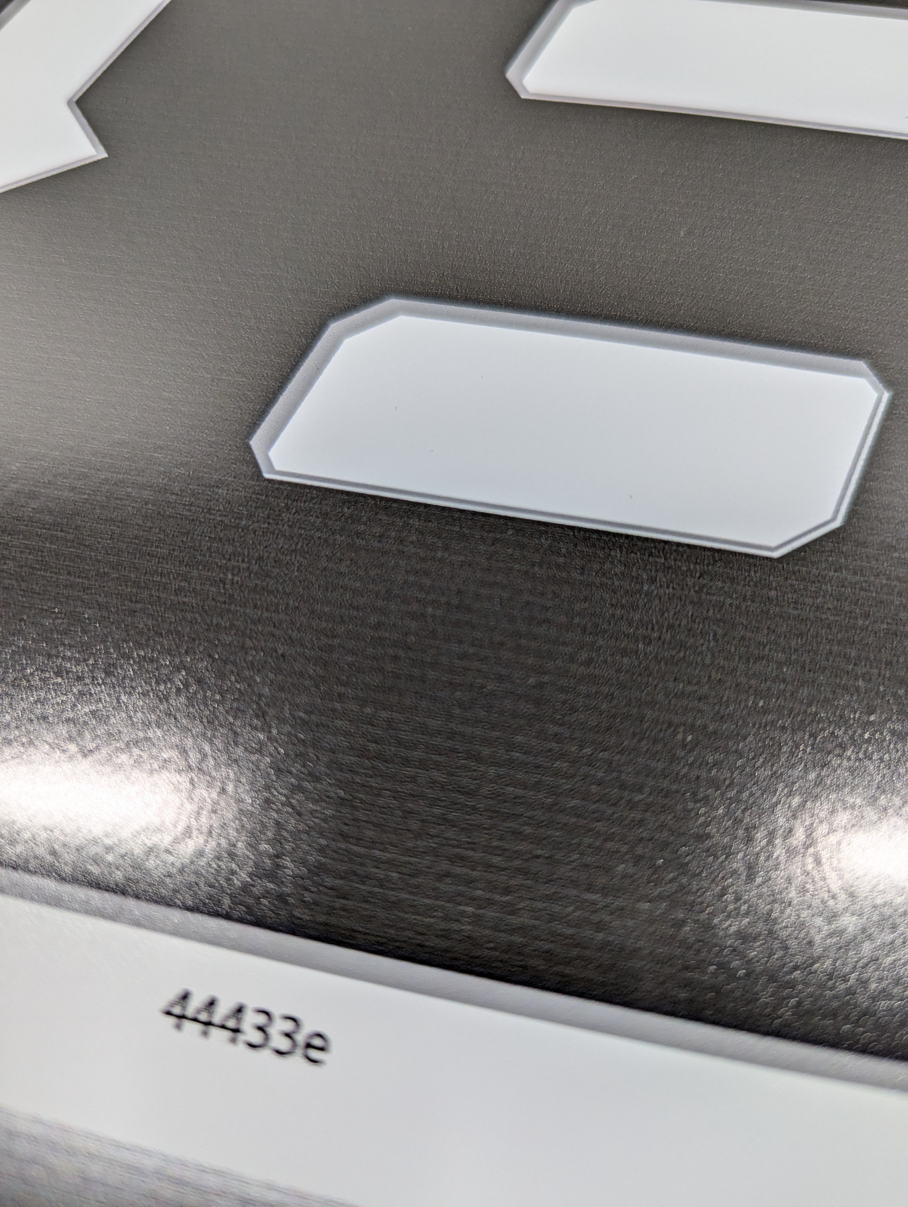

The other two photos were printed unidirectional on the slower setting. This was the solution the folks were using when I bought the printer second hand. First thing I did was change the head, cap, dampers, etc.
Is it possible to change the order of inks? I think it might be worth trying if I can put a light magenta or cyan in that damaged slot?
Any help is much appreciated!

You can't change the order other than changing the ink set from 4 or 6 color. It's in the firmware and there are no user or service level ways to change it.
