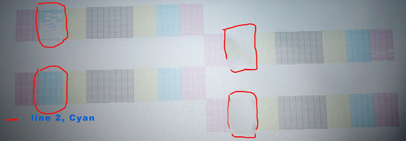

I have problem just on first line of cyan.
All 4 heads, on first line of cyan, on test print are missing. All other line are 100% ok. I did many cleanings, hard, normal, soft, filling. I clean the tubes with cleaning solution. I clean the print heads with syringe , I use cleaning solution from Mimaki and Alcohol 90% nothing works. I replace the dumpers, the cap station.
If I open the cartridge valve and i push the dumper to drop ink from head, and after that i do the test print, the missing line of cyan, appear. But after oane soft cleanig or 1 min of print with cyan ... disappear.
If I switch in head the cyan dumper with the magenta dumper and i do one hard cleaning, In test print i have cyan (on Magenta position) an no Magenta (in Cyan position ). After i put the Cyan and Magenta dumpers in place, the M is ok and C not.
What can I do more? What is the problem?

I am having the same problem all four left channels of all four heads cyan only I have replace everything from the cartridge to the heads including o rings and connectors and dampers please tell me there is a logical answer. Thanks for all your help

if it is universal across all heads on one side, then i'd look at some mechanical solution that is located beyond the ink lines (that is if you've done a damper swap and proved that the issue can be isolated to that channel and not the damper/line). are all the heads original to the printer? fi so, i'd entertain the idea of switching out one head manifold. there's a possibility that a bad batch of head manifolds went out and they are all equally defective.

we have replaced the dampers, damper caps, valve assembly and all o rings in between. i read on another post a guy had the same problem and it was a capping alignment, hopefully this is true for me to. all heads are firing when there is in in them as soon as there out there are only a few nozzels showing do a few good cleanings and wa la.... print for a few left channel drops back out once the head its self runs out of ink the tech was in and said its definatly a ink starvation issue, i have new pumps coming in today. i will also realign capping and see if we get anywhere.

"definitely an ink starvation issue" doesn't say much. that means he's flipped the coin and it's more likely ink than data. if you do a damper swap (crossing left cyan with the left magenta damper/ink lines) and the cyan issues migrates to the left magenta channel, nothing below the head is at fault. this means that the issue is held within the ink or ink delivery at those lines. so do that first before you start replacing capping stations or pumps, etc. if the issue stays the left cyan channels after crossing the damper/lines then the issue is sole to be found at the manifolds and down. the fact that the issue is across several caps and pumps points to it not being the caps and pumps. the odds are highly against a universal mechanical failure like that.
