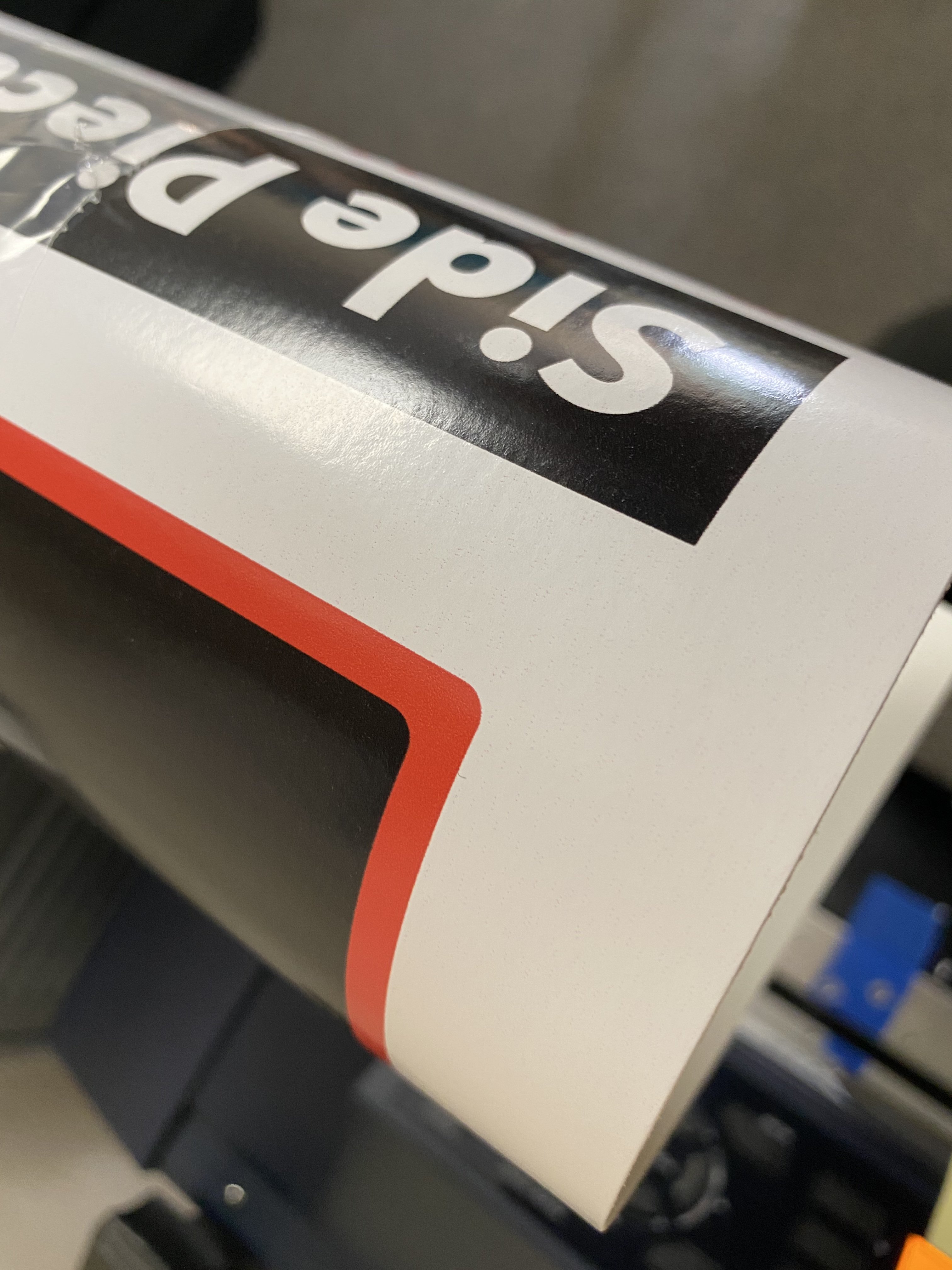

New to L365 so I'm hoping this is something silly I've done. I've searched Google, HP + Signs101 and I'm waiting on Grimco tech support but I'm hoping this wonderful hive mind will have ze solution.
Printing on HP prime gloss air GP + Endura 225 Satin, both supported medias + properly profiled and calibrated.
Noticed a very light speckling of magenta ink only in non-printed areas (white space in and around all printed objects but not on the first/last 4 inches of media) on AI, PDF + internal calibration prints sent to the press.
The light speckling looks as if I've set a 2% magenta screen down as a background color and the press is trying its best. Note that the speckles appear black in the photo.
I will run through the alignment/image optimization processes again tomorrow but it seems like they would have fixed the issue the first time around if they could have.
Thank you!
-Ian

Have you enabled the "Image-quality maintenance > Color variation and text-line correction" from the printer by accident?
That will produce something like this all over the print. Don't use it. Add color bars to the side of the print if you want more sharpness.
Your file shows 0.00% ink on that spot in RIP?
Thank you so much balstestrat, turning this option: "Image-quality maintenance > Color variation and text-line correction" to OFF did he trick! Also thank you BigfishDM, I'm joining that group on FB.
