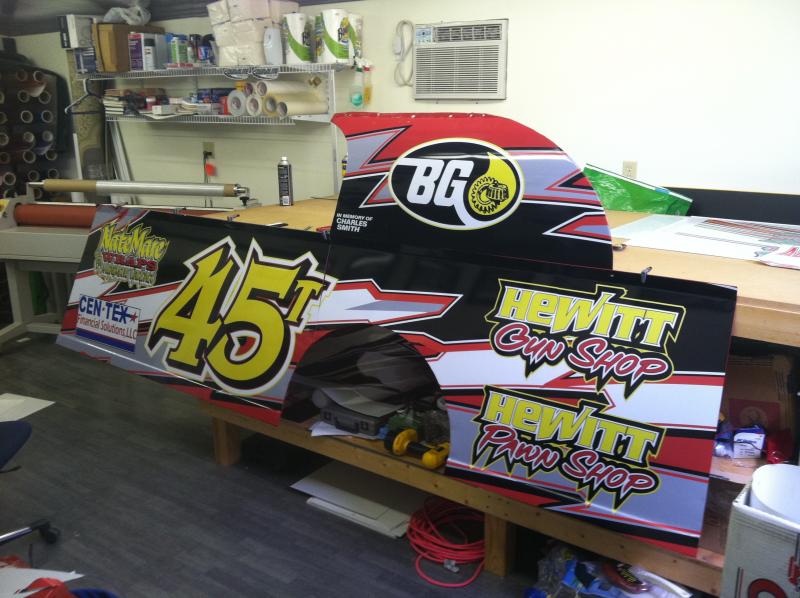

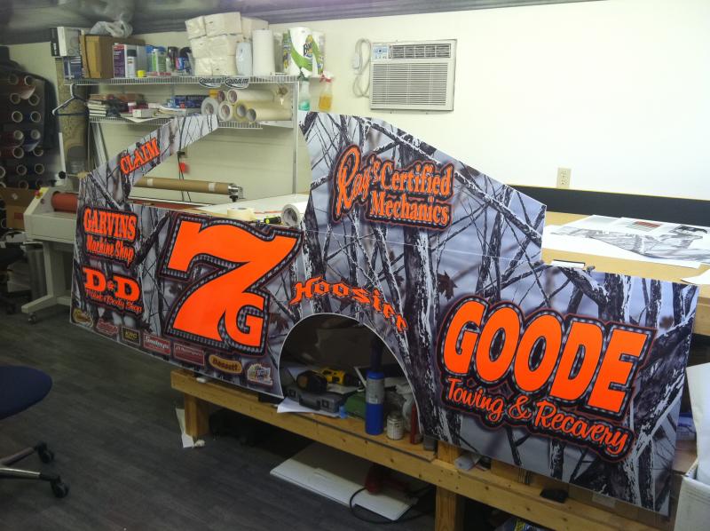

I have never had any problems with mine. I have been putting overlays under the lam for about 3 yrs now.
Here are a couple I have done.
