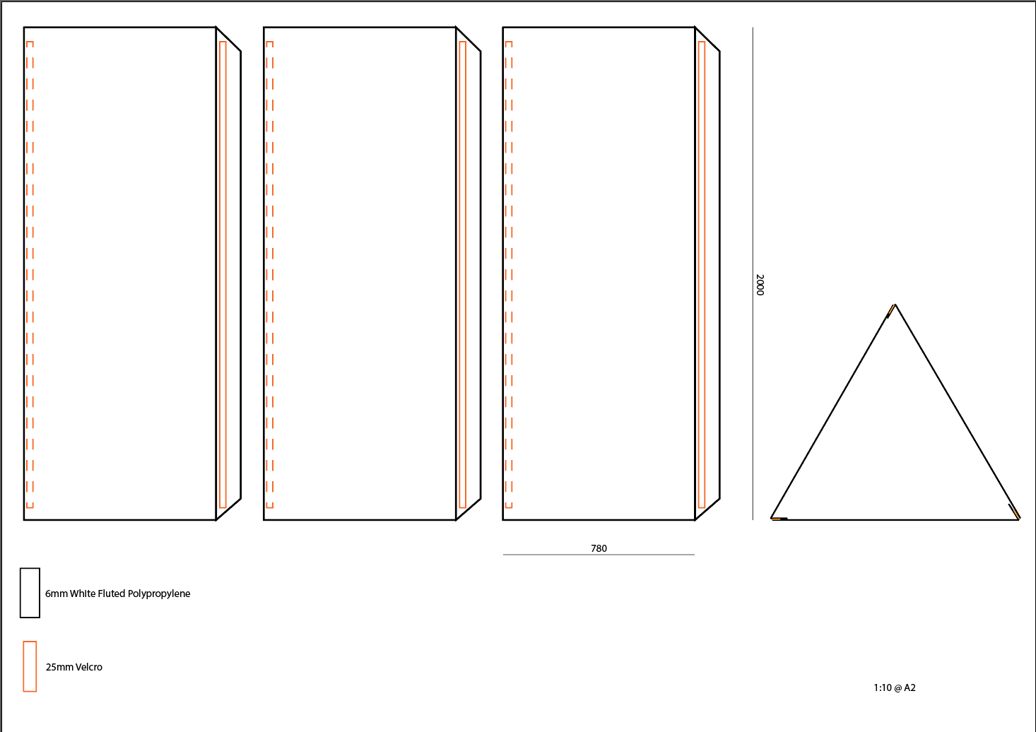

A client is asking me to produce 20-40 correx toblerones, each face 800x2000mm. I can print this on self adhesive polyprop, and laminate with polyprop (no vinyl allowed). I'd get in 6mm (possibly 10mm) correx, and cut the return for each face, and join with velcro. The printed images need to be photographic quality, for a longstanding client, so I'm loath to sub this out.
