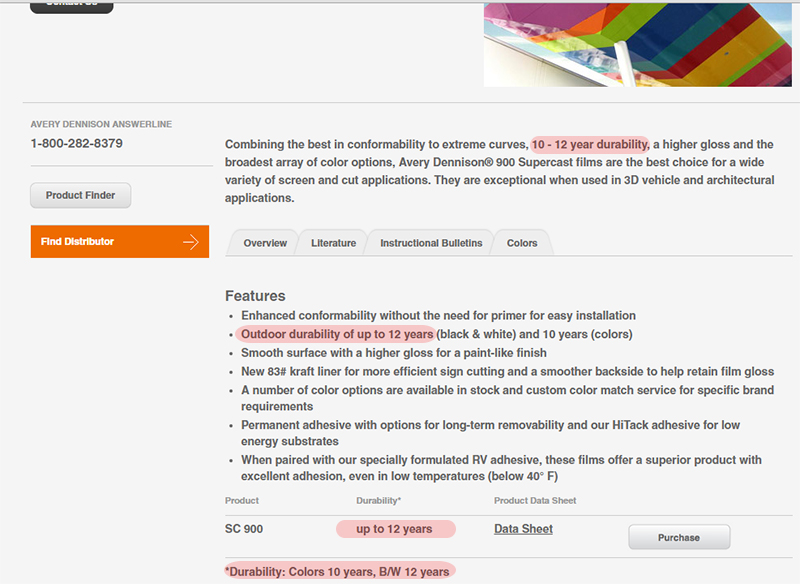

I doubt it will hurt, but it seems like he's going to extremes. The stuff is warranted for 10 to 12 years without laminate. I see no real harm, but I highly doubt the customer will wanna pay for added protection that isn't needed, unless your boss bamboozles the customer into it.

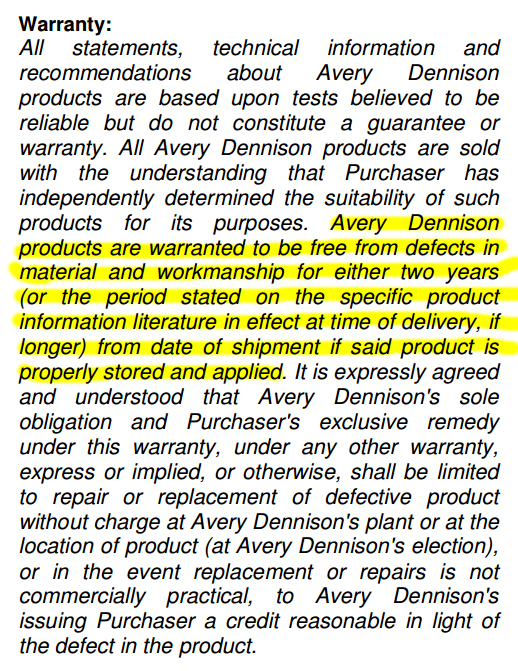

Be careful as your statement in bold is not true at all from any manufacturer. That is just their suggested life span.
Yowsa, you're absolutely right. I thought with their mentioning it 4 times it really meant something.
Sorry, Gino. But warranty and lifespan are not the same. Just like with cars, appliances, etc., the expected lifespan is much longer than the warranty.
See here: http://graphics.averydennison.com/content/dam/averydennison/graphics/na/en/documents/Product-Data-Sheets-NA-ONLY/SandC/opaque-sign-cut/supercast/PDS-SC-900-Series-Opaque-EASY-APPLY-CR-MW-rev-1-11-25-13.pdf

Now, I would expect the vinyl to last longer than the warranty. But there is a huge difference between those two terms.
If I tell a customer that something is warranted for 10 years, then they'll be back in 9 years, 11 months for me to completely redo the work for free.
Telling them the expected lifespan is 10 years does not create the same liability.
Yeah, I see that now. I think it's quite deceiving, but they, like almost everyone else, know how to cover their a$$es.
