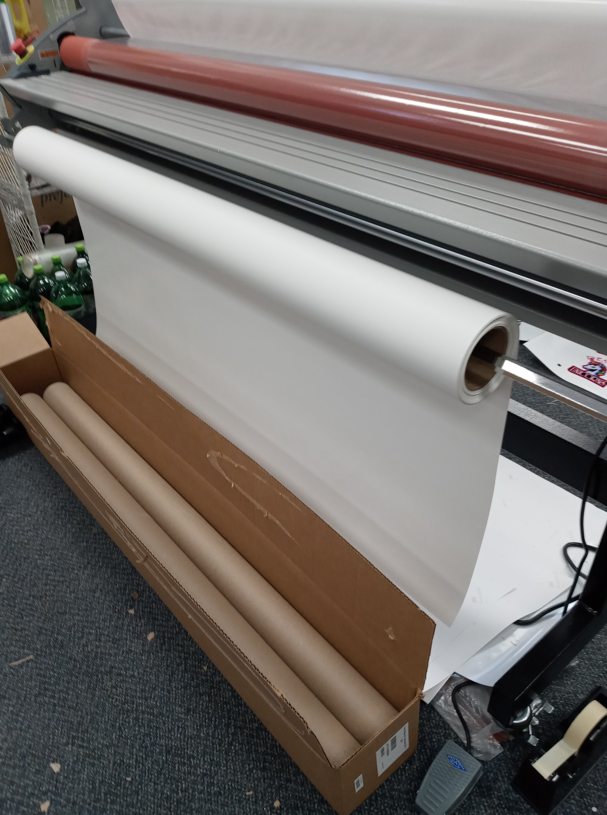

This is my quick and (really not very) dirty method: a vinyl box with 2 cardboard cores resting in the bottom to hold the roll of printed vinyl as it's pulled through the laminator. It's a lot quicker than loading the roll onto a bar that I then would have trouble lifting by myself. I keep a roll of scrap backing paper on that front bar.

I do that too! For a shorter run that isn't long enough to put on the actual roll. Never thought of putting cores inside the box though. I just have the flaps down to form a v

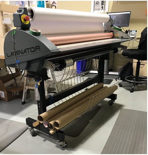

I guess I've done both; in the previous shop, I had room to run out on a table, kept the print flat and clean, quick to trim and process.
This shop is tighter, so I had to manually roll it onto the take-up roller ( 3" core) which was almost a waste of time, especially if it wasn't tracking well. Finally bought a couple more of these wire catch baskets and zip-tied them under the laminator. I rarely use the in-feed roll holder, it just doesn't seem to tolerate ANY mis-alignment of the feed thru the rollers =....waves....buckle.....wrinkle.....@#&$^#%!!! Royal Sovereign RSC-1401c
The pic is worth 1000 words. The more large wraps I do, the more I want a power take-up, and heated laminator!
