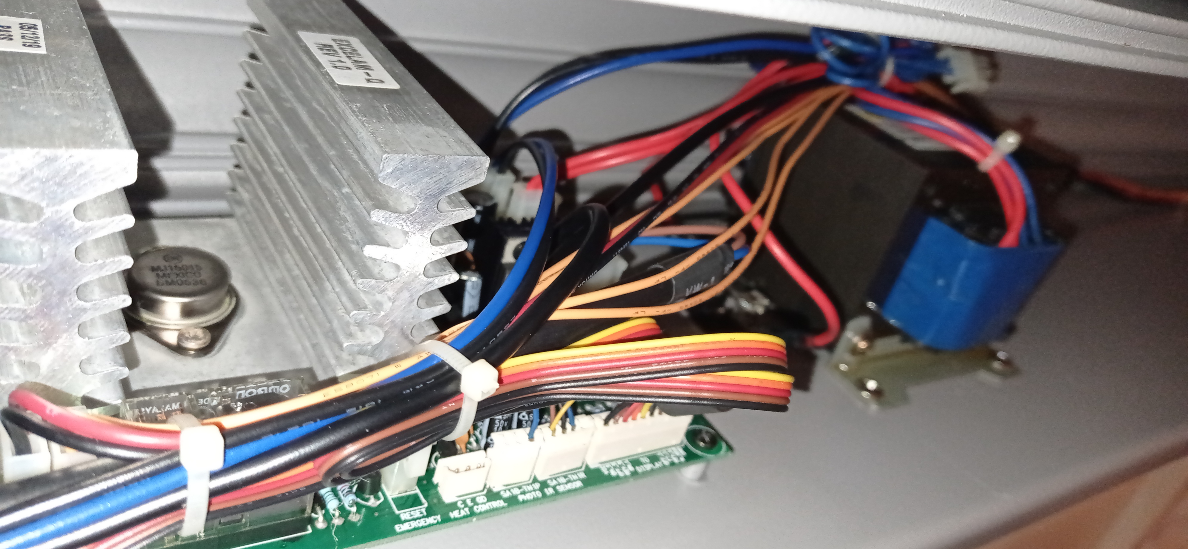

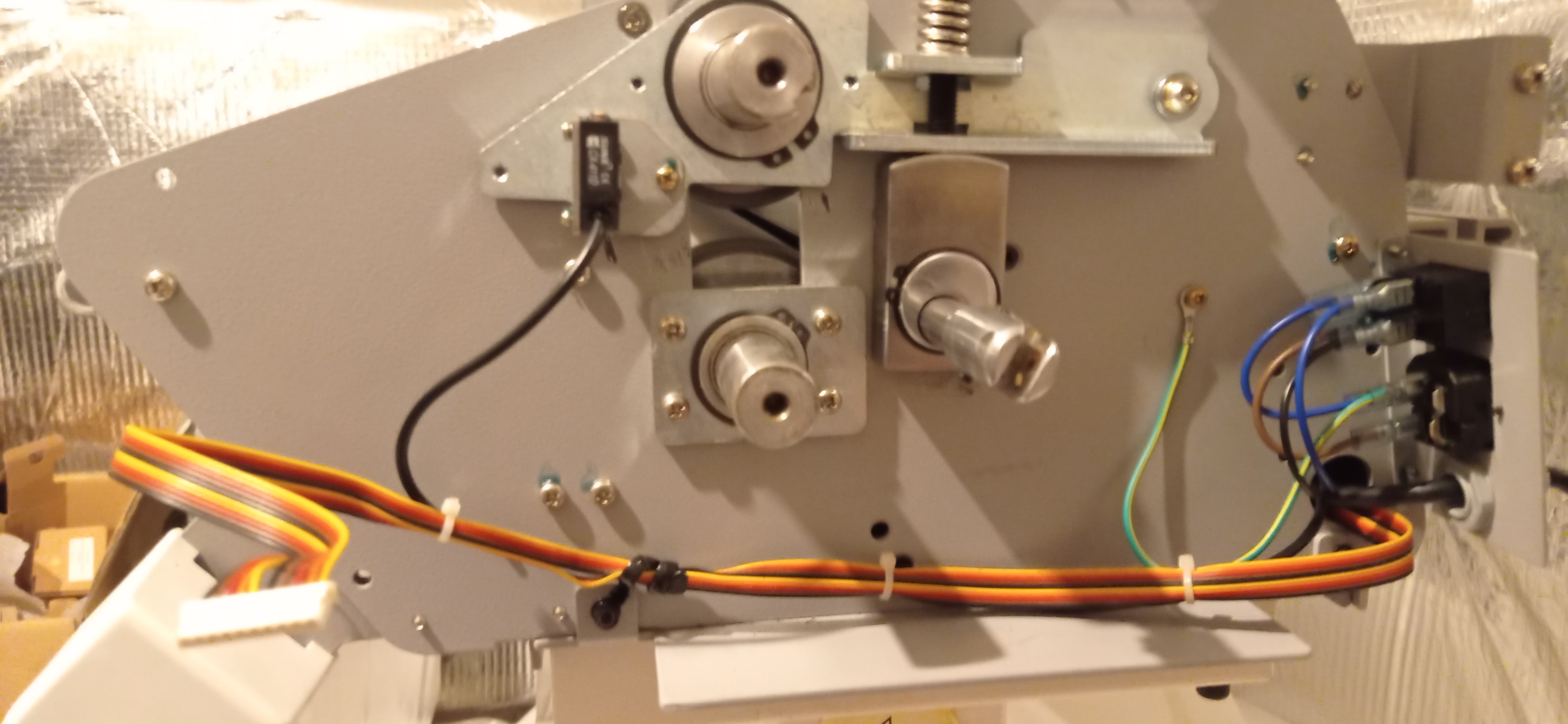

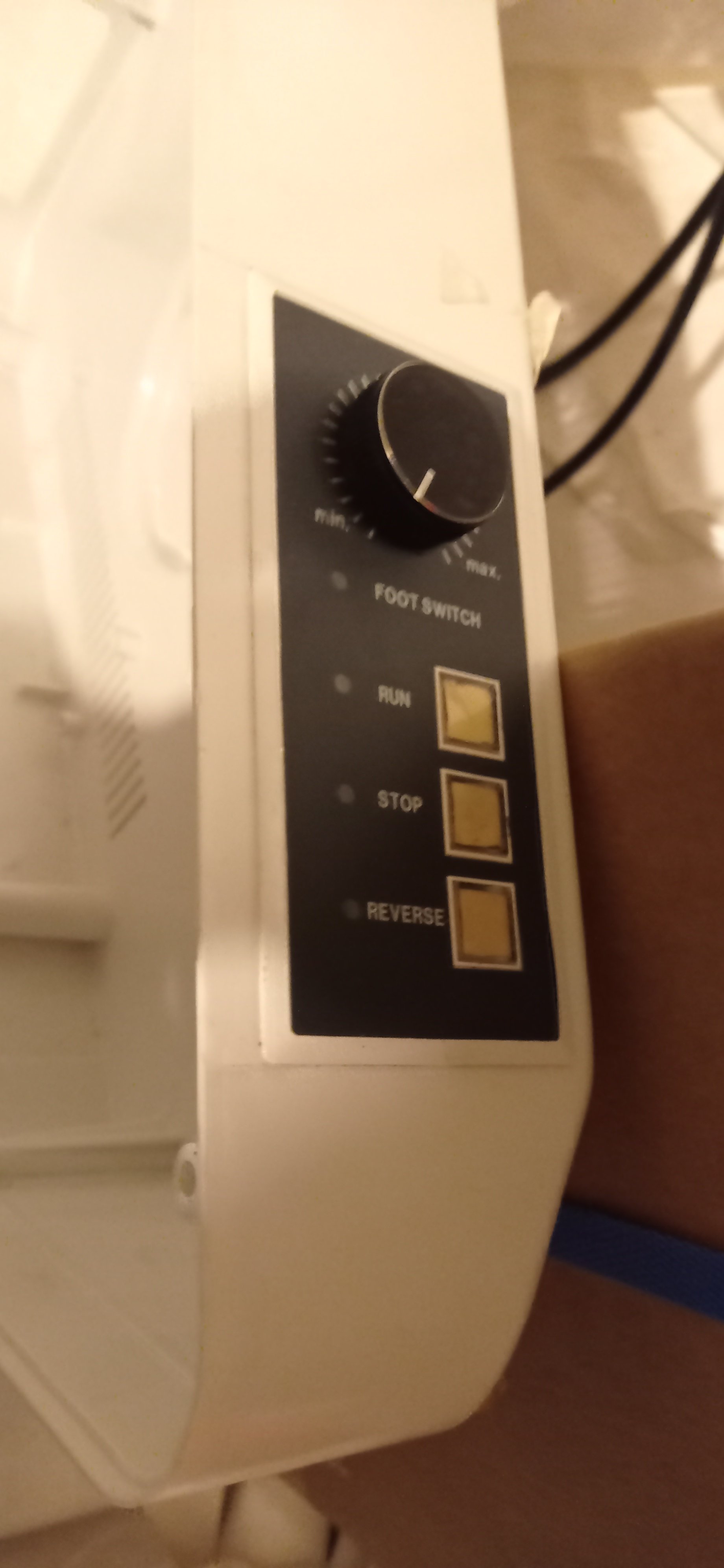

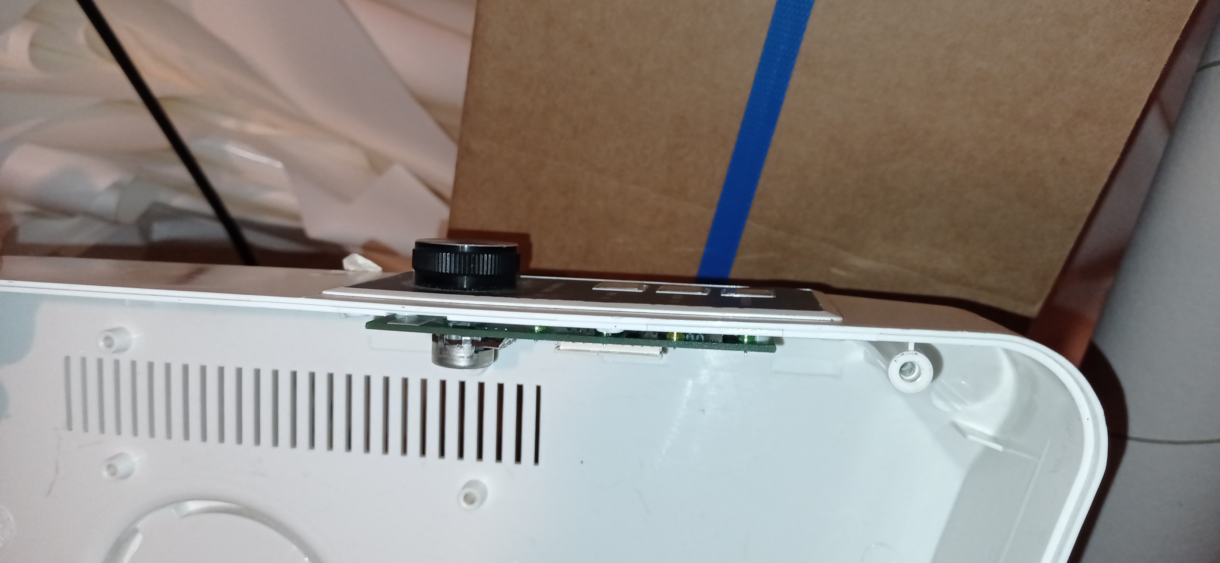

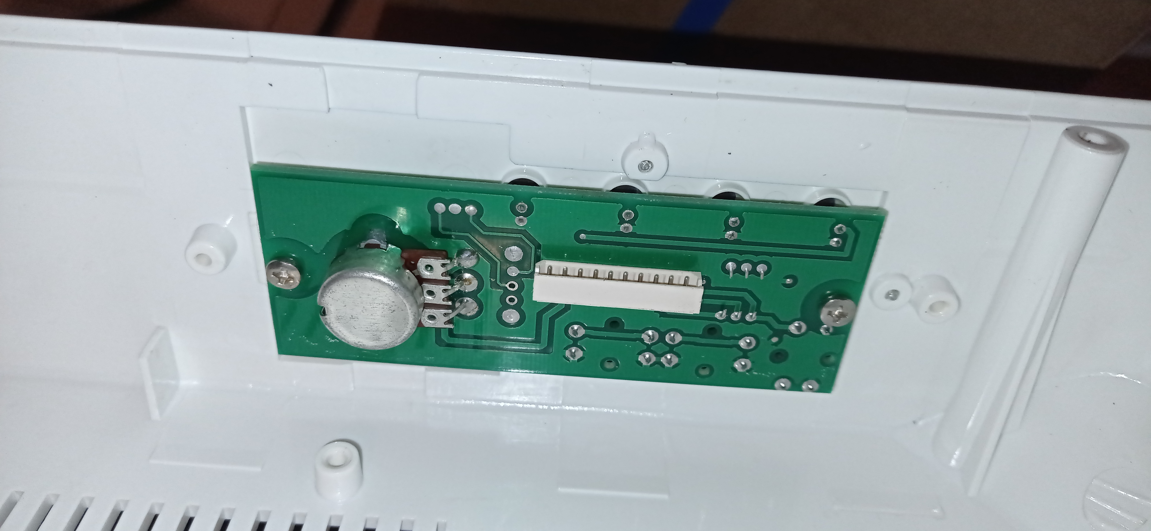

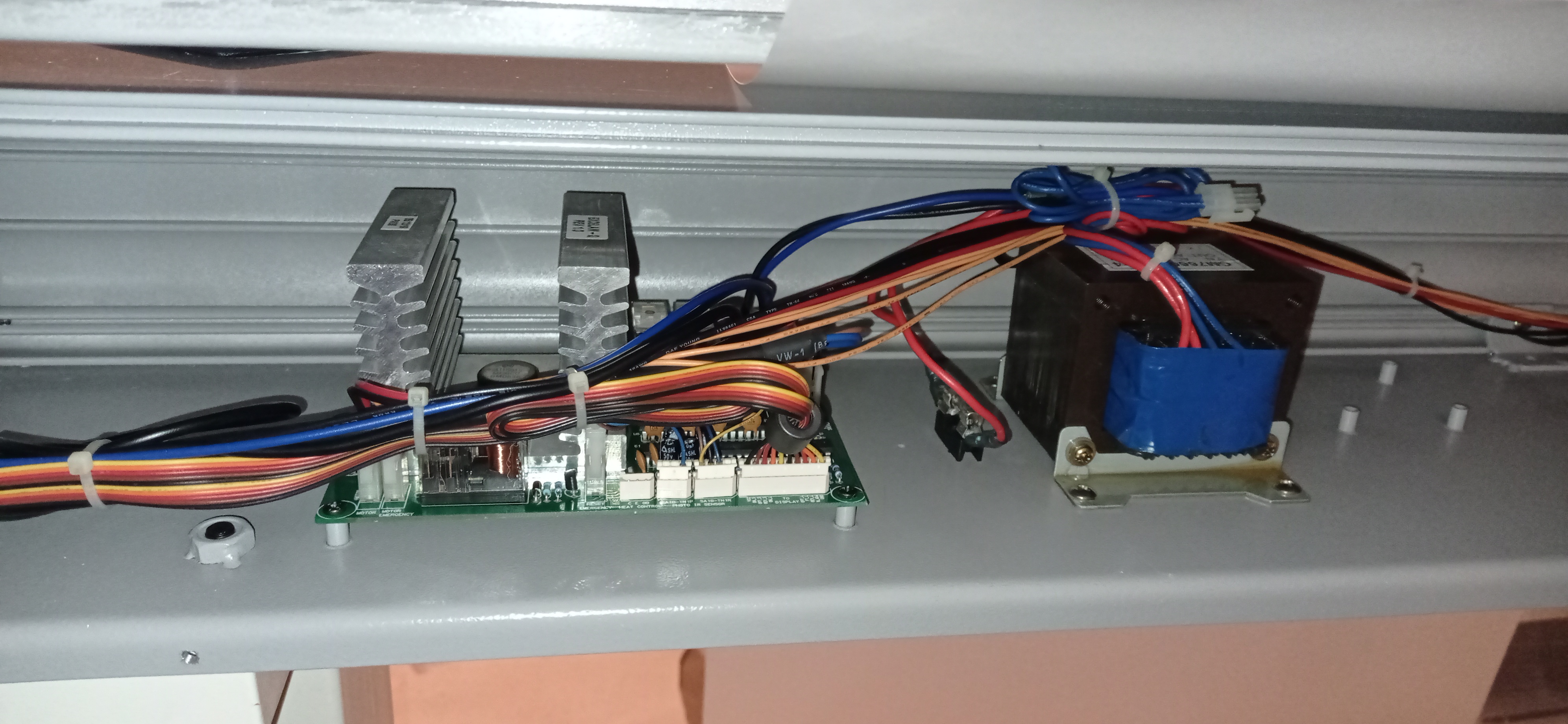

here some picts, don't know if it can help

I suspect your speed control potentiometer may need to be cleaned or replaced. It's the round thing underneath the speed control dial with the three electrical connectors. I've had to do this with my laminators.
On your machine, it looks like the potentiometer is soldered to the control board, so you may need to replace the whole board. Try cleaning it first, if you can get into it. (Make sure you disconnect power to the machine first.)

netsol
there is probably a shorted power transistor, triac or that sort of thing. (the devices attached to the heat sinks)
if you have never done this sort of thing, try to buy a board, or take the board to someone with an electronic background
i used to say take it to a tv shop, but that just shows my age.

Ok thanks, i suspect the board underneath the speed control dial as i've faced problems with the stop button this last week, i had to push it hard to make the laminator stop. I'll try to clean it tomorrow and see if it make any change.
@nestol you are probably talking about a board on the back of the machine, i'll try to find someone who repairs electronics board but it may be quit hard to find in those days. If you can help me out with the pictures i've sent please do.
I'll first try to clean the little board tomorrow and then will look further else.

Since you've had other problems with the controls, perhaps the problem could be with the ribbon cable that connects to that board.

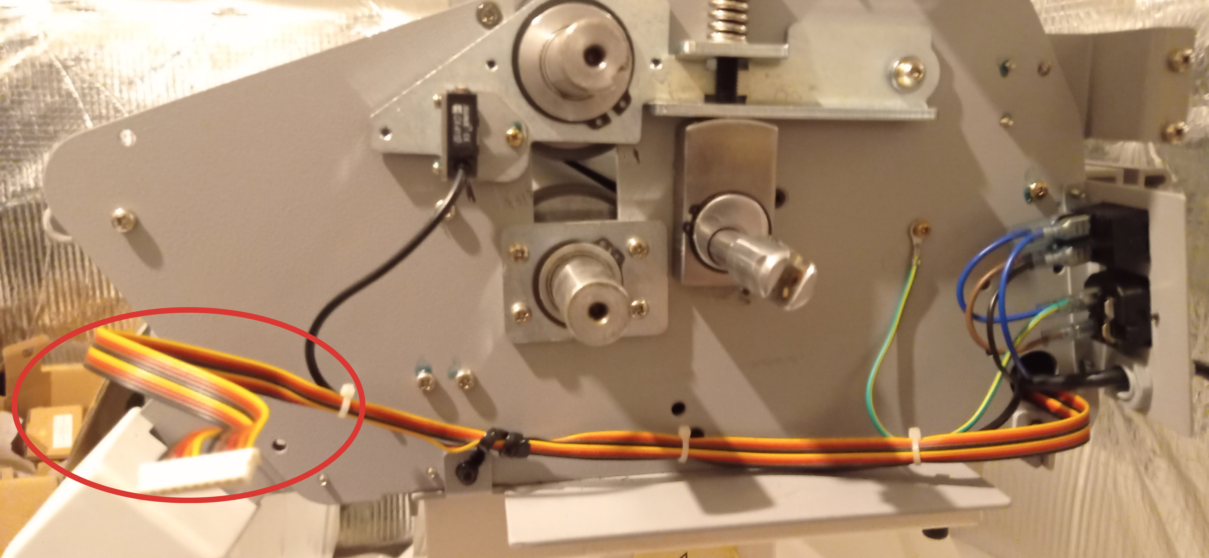

You mean this one? i've checked the connections of the cables throught the plug and the connection to the board itself and it seems ok, what do you mean?

Yes. Since you're having problems with other buttons besides the speed control, the problem is probably not with the potentiometer but with the board, or possibly with the cable that connects the board to the works.

ok, i can't see how the cables could be defect as they are not cut or out of the plug, all wires seems at their place. if you have another idea please tell me.

I had a similar problem. Replaced the control board with the speed controller on it and it solved the problem.
