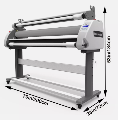

This is our current Chinese "AUTO LAMINATOR" it works great...63" pneumatic roller pressure (came with compressor)...its set more vertical, takes up less space and has a better takeup roller than RS...
I use the takeup on mine all the time and dont need much room or a runout table like a shop I used to work at...
got from a reputable sign equip supplier 7+ years ago...it came with spare glass heating rod I dont use and a couple spare handles and knobs I havent needed...but I also doubt it would be easy to get replacement parts...
the only problem I have had is the plastic pressure valve on the compressor blew one night so I had to buy a new fitting for easy fix...
If you have tables front and back the right height and take the Lam Holding/peeling rollers off it can even do a decent job mounting signs...not as easy as a Rolls Roller table but works in a pinch
Chinese Auto Laminator on Ebay

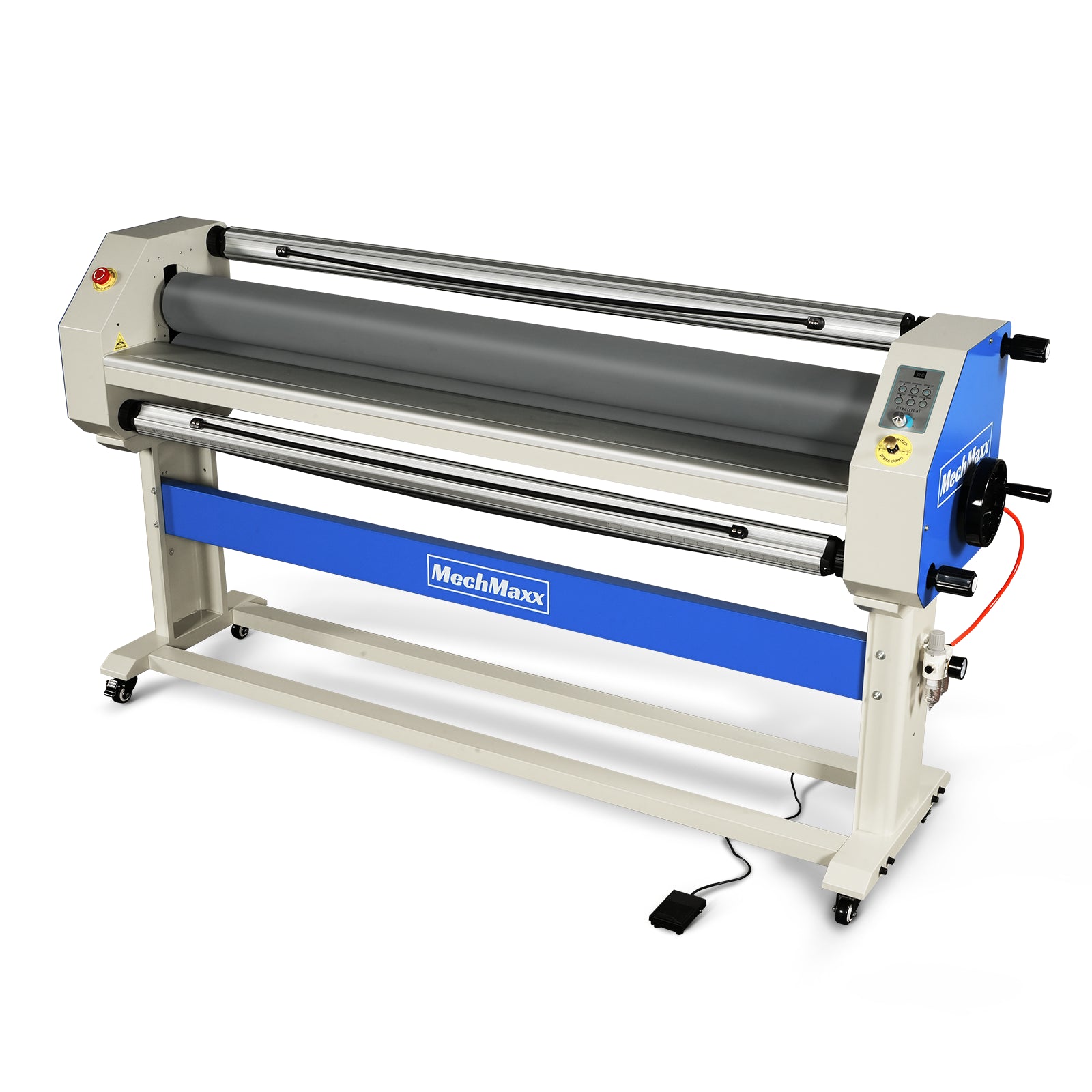

I recommend the brand MEFU, also from China. Large-Format Laminator with Smart Control System, which makes it easy to check the Temperature, Speed, and Lamination Records for 30 days.
Also Pneumatic Lifting needs to be paired with Air Compressor. And we also have Manual Lifting. Support Cold and hot Lamination, Temp could be adjusted.
