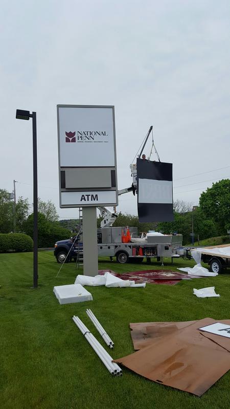

some of our trucks have sign forks but some do not. We also have a couple trucks with in basket jibs which are the best. Here is one person installing 10'x8' faces. We still have single man fiberglass buckets that we do 30-60 sqft faces in everyday. Just have clamps and rigging for all the situations
