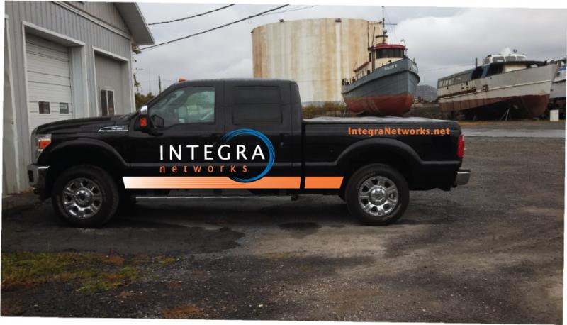

Looking for some critique on this layout. Logo is set in stone, mainly looking for opinions/suggestions on the stripe. Customer wants some type of stripe or swoosh in there.

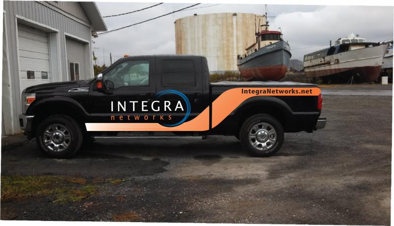

Not feeling it and can't really offer a suggestion at the moment but I know that isn't it. I'd try some other ideas.
To me, all your emphasis is on the stripe. If that's what you want, you nailed it.
Otherwise, re-think your plan of attack. What do you want people to see, kinda first ?? The name, perhaps ??
Besides, that stripe cuts the truck in half diagonally and front to back... all at the same time.
Nope.
Now, you've made it 'Bottom Heavy'. One's eyes just go to the main focal point...... at the bottom.
Marlene
#5 is better. maybe make the blue swirl a little lighter blue and the stripe a darker blue so it is there but not popping more than the logo
artbot
i like the second one quite a bit artistically. maybe lighten the "networks"? otherwise it's clean and very professional/big business looking.

I'll try changing the color of the stripe tomorrow and posy. I think that might work better. Thanks for the suggestions.
Locals Find!
I actually like your first version. My eye was drawn from the logo right into the website. I don't have any degrees in this stuff or as many years of experience as the others. However, I do know what occurred when I looked at the mockup.
So, if the point is to get the name out there and get people visiting the website I would say #1 will do the job nicely.
If the point is just too look artistic and never make a dime well, you always have the other suggestions.
bob
Boring. Not worth a second look or remembering the first look.
Perhaps you might try losing the orange and using some sort of electric blue[ish] immediate background that somehow instantly signifies 'network'. Or something. Anything but the yawn inducers you currently offer.
