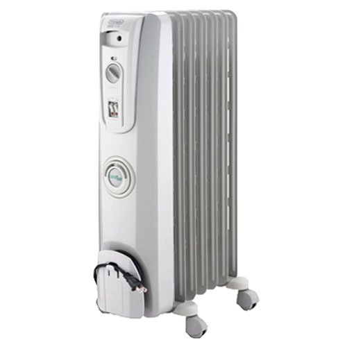

Yes, I use two of those common free-standing oil-filled plug-in heaters that have a thermostat.
