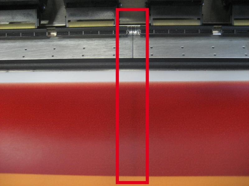

Im printing some full color print, and i always get vertical lines, where the vacuum and heating plates are joined. (Rockhopper I)
I have tryed lower temperature... from 26 - 36, no good...,
tryed vacuum low - high, no good...
Do you also have such problems?
tech guy couldnt help me eidher...
Thank for reply!

You could put aluminum tape over the seam to even the heat distribution. Same tape heating contractors use. It can be found at any hardware store.
studio10
Yes, put piece of aluminium tape or folio where the plates are joined.I have the same problem especially on full red and brown print. When I got some time I`ll try to disassemble heating unit and to move heating plates closer.

How could you move plates closer? i think there isnt any place, to move them closer...
studio10
I bought tape in Merkur, it is silver and twice expensive then regulary tape. Or you can use piece or aluminium folio and stick it with regulary crape tape. On this forum one or two years ago one users advice me to disassemble heating unit and to move heating plates closer, but I did`t try it yet. When I look in service manual I think it is possible. When I do it I`ll inform you.

i still cant imagine how could you move plates closer, when there isnt even 1mm space between them!
ok, will wait, untill you do it...
