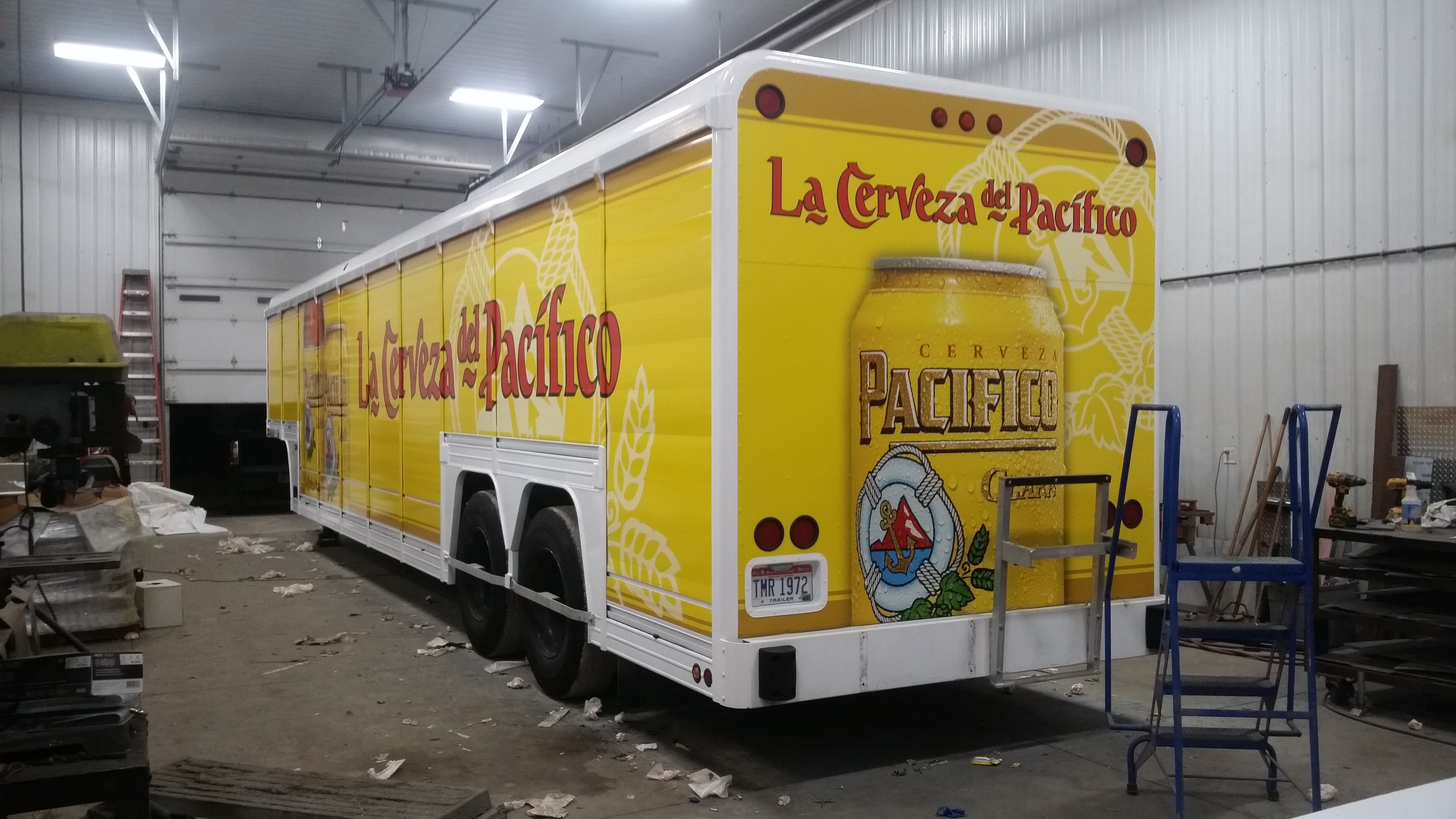

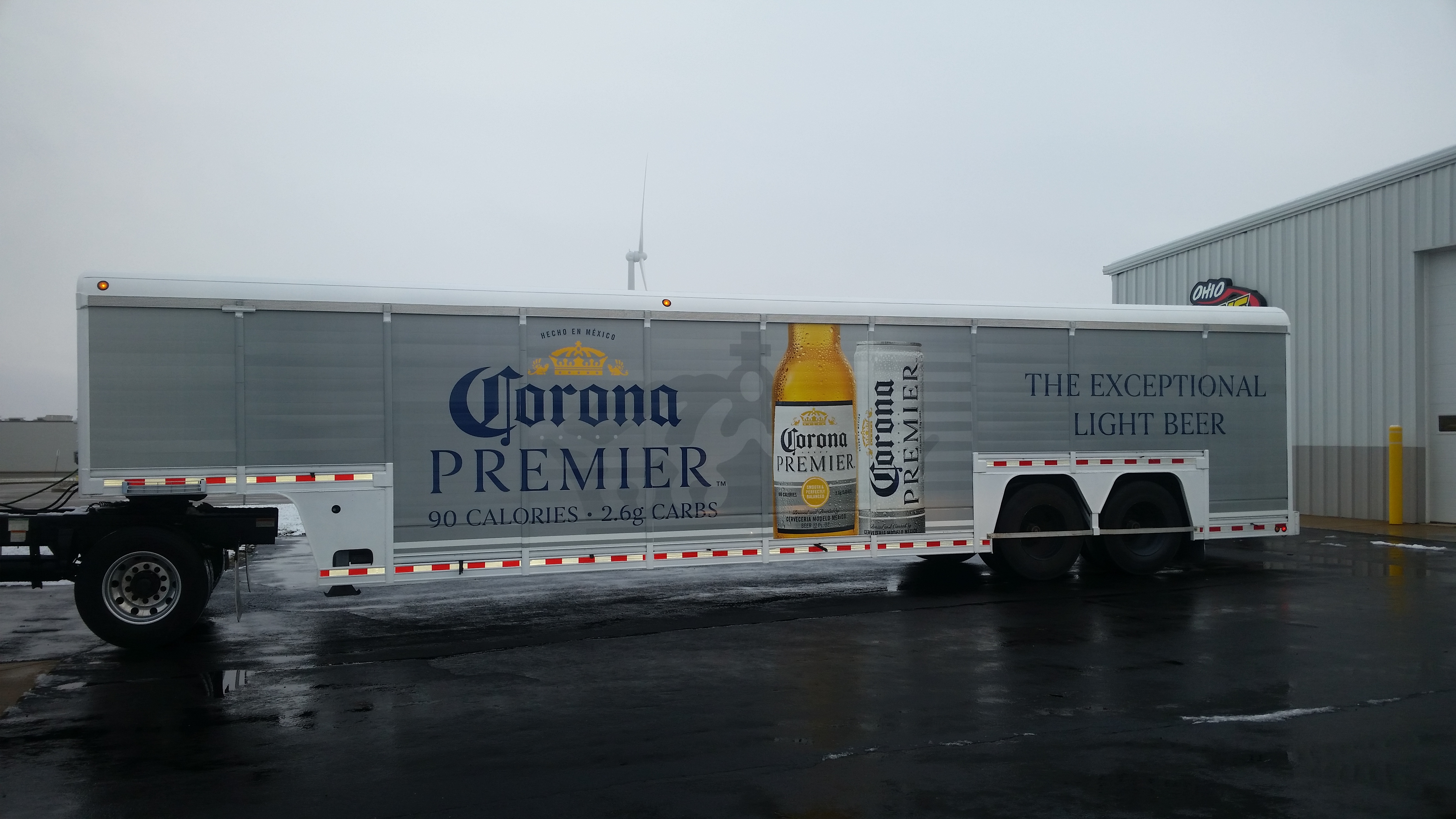

I have installed a couple wraps on beverage trailers that the wrap was supplied by a print house the customer uses and they used 3M IJ180 with liquid laminate and premask. Install was a PITA but I had to work around the protruding vertical bars between the roll up doors. The premask gives the vinyl some strength and rigidity but doesn't allow for stretching, and without a film overlaminate it made it very difficult to install. The vinyl was very brittle and once it stuck if you tried pulling it back up (with and without heat) it would tear. It was very unforgiving. If you are installing on a perfectly flat area without rivets or screws I'd say go for a liquid laminate. Note that removal if you have to do it in the future will suck. In my opinion though I would use a film overlaminate to make installation and removal much easier. In the end it will be a better product for your customer. If you don't have the capability of laminating find a local company that will laminate it for you or possibly think about outsourcing the print job. Here's a couple of the trailers that these wraps were installed on.
