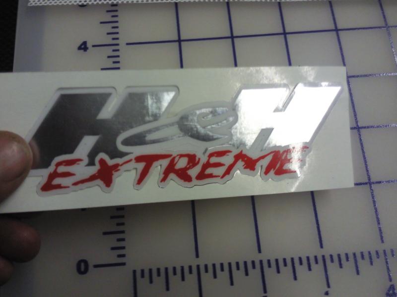

Someone on here has to be able to tell me how you print something like this. Its like a chrome or something like that, Its on white vinyl with laminate over it.
Fred Weiss
Merchant Member
Commonly done with a Gerber Edge. They have a number of shiny medal foils available including silver. None are recommended for outdoor use however, where any significant image life is a requirement.
Border
I'd say it was printed on the chrome vinyl using white ink or white thermal (Edge or DC3 etc.)
What does the back side look like when you peel off the liner? Is it white, or chrome?
