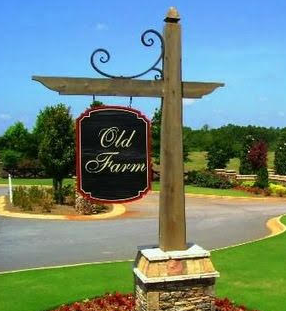

I've got a customer looking for something along the lines of the photos below. As far as the posts go, is there a good resource for something like these or would they be a DIY project?
Any help or tips would be greatly appreciated!

+1 for Foamcraft. That's who I use for signs like this. I'd go HDU, they have a ton of stock shapes to pick from, or do custom ones. Don't even have to paint them, they'll sent it finished and ready to hang.
Poles, do them yourself, or just sub it out to a local woodworking shop.
Other than designing it, you can make the rest as easy as assemble, install, and collect a check.

They're easy.
6x6 cedar for the upright, whatever length, width you want for the cross bar, simple cross lap joint to connect them, bolt together, an L bracket on top so it's hidden for added support (if needed), and you have it. Make it fancy? Bend some mild steel or aluminum flat bar stock for decoration, taper cut ends of poles, maybe some notch cuts for aesthetics, add a little paint & stain to protect it, put it in the ground and hang yer' sign.

Simple project, 4x4s or 6x6 w/4'x4 or 4x6 arm, many options avialable.
Lap joint with glue and thru bolt (I use galvanized carriage bolts)
long eye bolts thru arm, again galvanized or stainless. You can add stock scroll brackets for decoration.
I often add a skirt board a few feet up around the base.
When I install them I use a piece of sono tube to create a collar of concrete a few inches out of the ground
to protect the post from landscapers.

There are two "vinyl" shops in my area that don't have space or the desire for metal or woodworking projects. So they (used to) farm it out to me.
If this is something that you would like to add to your repertoire, and make it profitable, seek out a "craftsman" in your immediate area who can make these for you. Meet with him/her in person to see what materials they can come up with, what is within their capabilities, time-frames, etc. The appropriate wood also MUST BE sealed, primed, and painted for extended periods of outdoor use with "minimal" maintenance. Buying from someone on the internet, to me, is taking a risk of what they use and how much care they put into their projects. Once it's in your hands, they are out of the equation for future anything. It's all on you.
