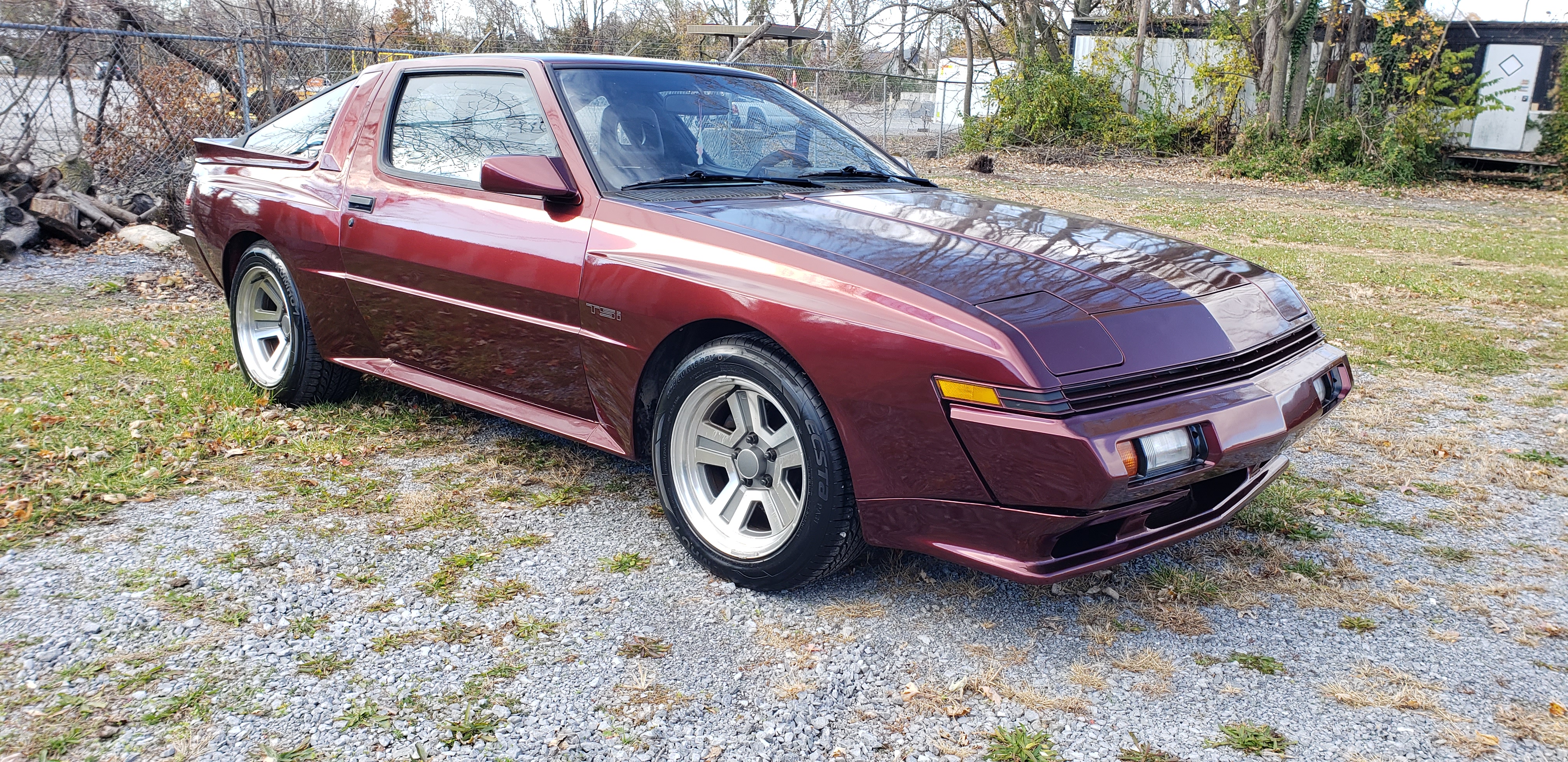

I'd also like to throw in KPMF for color change film. Just did an install on my 89 Chrysler Conquest TSi.
First time working with it and as far as installation goes, it worked out awesome. Very easy to apply, and looks awesome.
