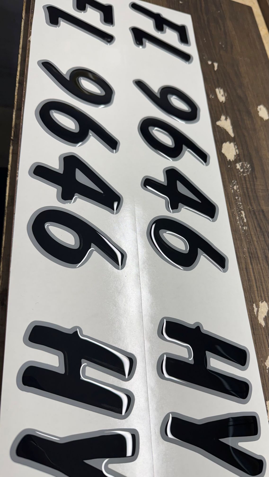

Hello, can anyone help i have been DOMING for over 10 years on vinyl letters but lately it seems like doming product has gotten worse, i use plenty of suppliers like,
-RDS ACCUFLOW
-DOME IT
-DOMELAB CRYSTAL and their product just doesn't cure properly anymore due to the change in materials, i also used Richardson supplies which works well but they
seem to be out of stock every other month or so.
I used both a 1:1 & 2:1 mix ratio in a 50ml and 75ml bottles.
Any help on new suppliers will be appreciated.

We use Dymax for our resin that we use on name badges. How are you curing these?
these come in a 50ml bottle is a 2:1 mix ratio and cure after 18 hours, some resins iv used from another company cured in about 4 hours, room has to be low humidity. how does Dymax work ? is it a bottle that comes with a tip mixer or you have to do your owm mixing ?
Superior_Adam
I know they have different types. We do not have to mix anything and use about 5-6 5 liter pails a year. Ours cures using their conveyor with a high intensity light so it cures in about 15 seconds.
