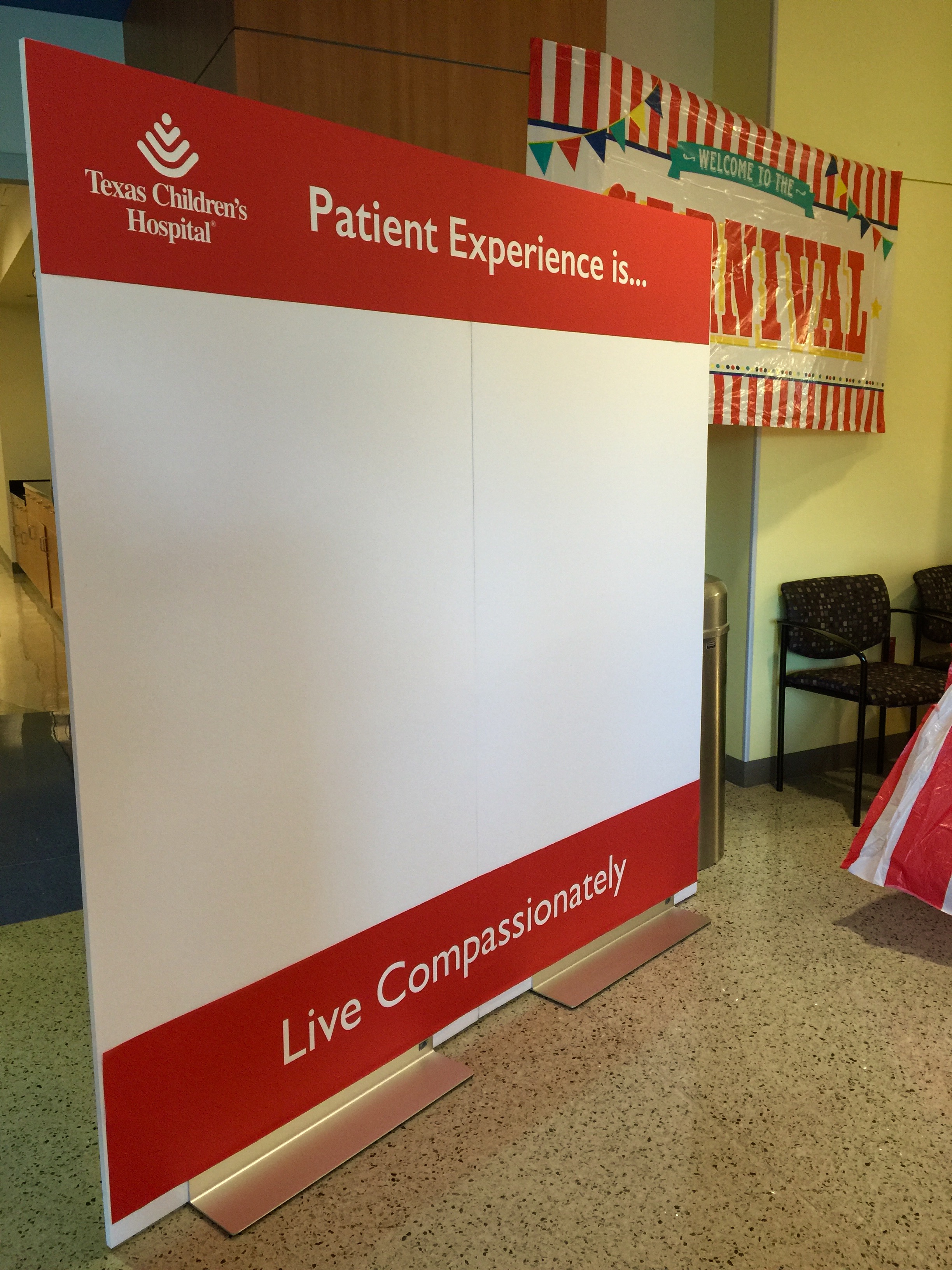

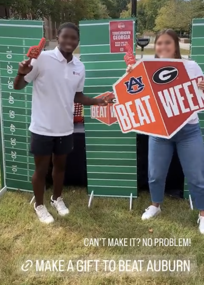

A regular client sends us the attached photo they found online and they're looking for standing sign boards similar to the green ones in the background.
They're looking for something durable enough for repeated use.
No artwork yet but they're planning on around 3ft wide x 5ft tall.
Any recommendations for stabilizer feet?
I saw at our regular vendors are SpiderFeet but I can't find any specs on what sizes they're 'rated' for so Im not sure what size to get/how many per board/or if they'd even be sturdy enough.
I would imagine it would be pretty easy to custom cut some feet out of 1/2in foam or 10mm corro but we don't have a flatbed cutter.

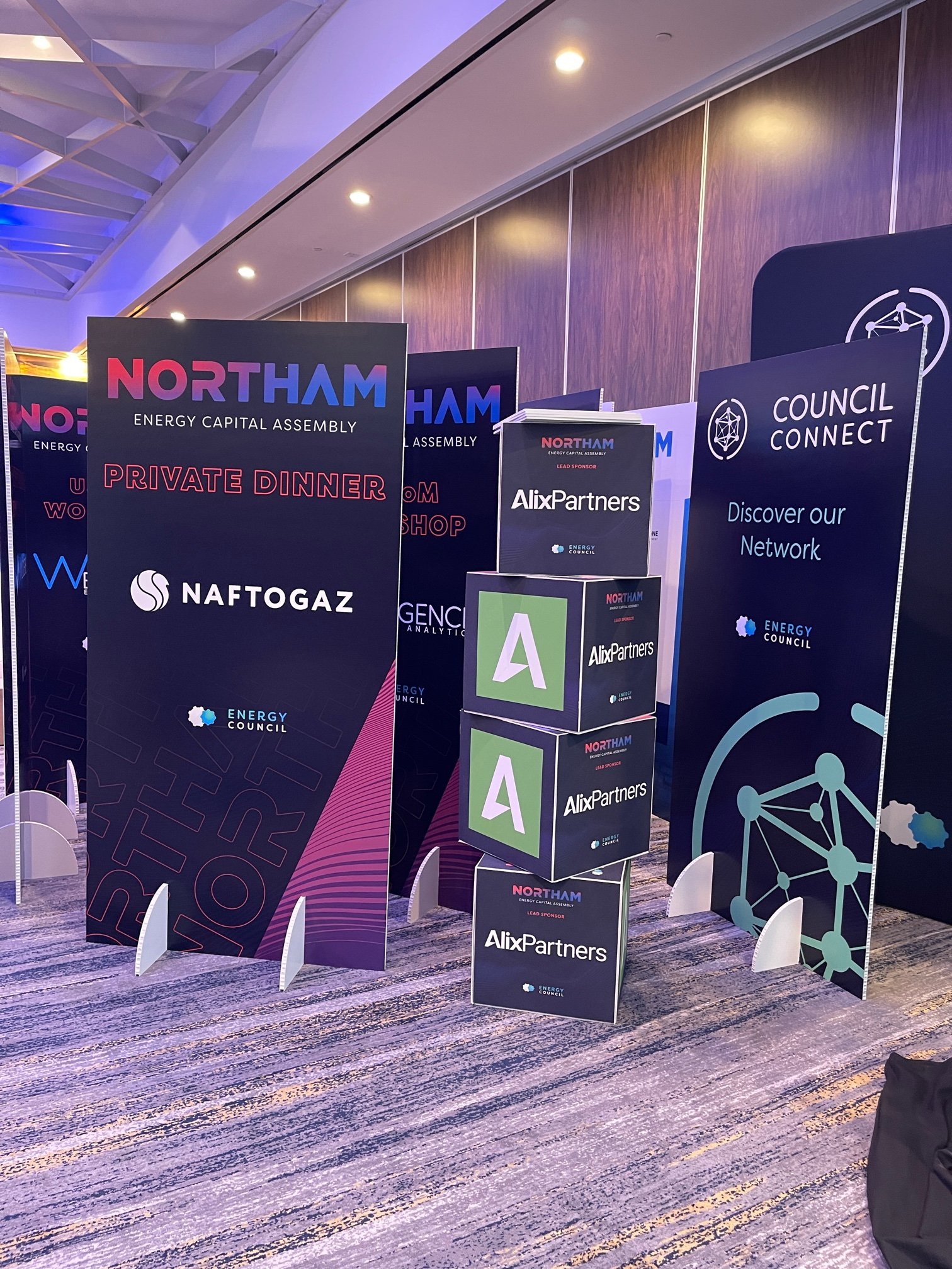

We use a lot of these from Expolinc.
Not the cheapest but by far the best and most durable we have found.
for more temporary use we cut them out of the same board, either 1/2" Infinity board or 1/2" Eagle cell. Make sure you cut openings on both ends (board and feet) for stability.
We can even share the illustrator files we use, if you'd like.

View attachment 161959 . View attachment 161960
