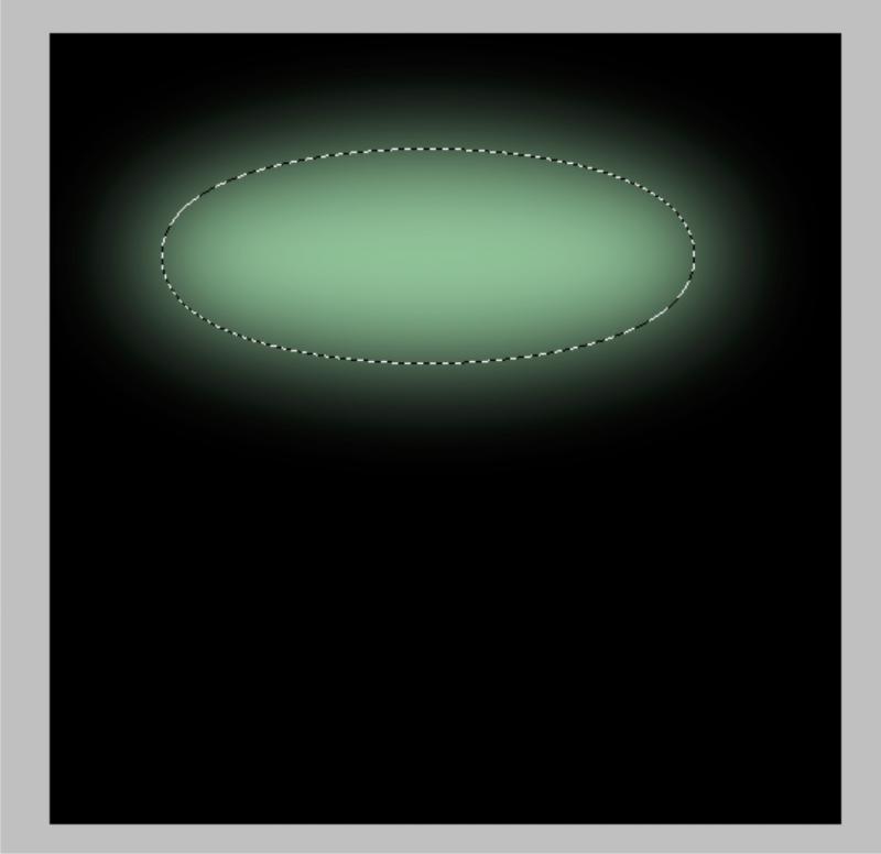

just making sure you are talking about the green that fades into the black...
marquis the circle at about the midpoint of where is is solid and where it wants to end...feather it quite a bit (select -> feather) then fill (edit -> fill)
see attachment for where marquis was for end result
