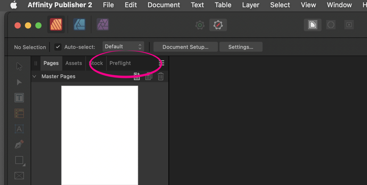

Affinity Publisher has a preflight tool.
I don't use Publisher very often, I could get by with just Designer for my workflow, but when I do use it, preflight pops up every time I export anything. Don't know how in depth it is, or if there's any automation, because I just don't use it that often. Publisher is their alternative to inDesign, for stuff like the OP is lookin' for, might be worth playing with the free trial to see if it fits the need.
