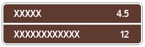

I need 2 18"x40", 2 12"x40", and 2 6"x40" reflective signs with radius corners like the image below. I don't care if it's on acm or aluminum.

What grade of reflective?
Are you looking for a printed or plotter fabrication?
There are several MM that should be able to do this

ABA Visibility Products
Those look like they are intended for roadway, what does your local MUTCD specs call for?
Look for a local street sign maker. The kind that make street signs, only. Many times, municipalities have their own department.

They're actually for a walking/bike trail in a park. They don't need to be made to a particular spec, they just want them to look like "real" signs.

My experience is that ACM will NOT survive anywhere within reach of vandals. If you are investing that much money in a sign, installation etc.....especially if reflective, then use at least .080" aluminum like traffic signs. That long a panel needs support in at least 3 places, or they are easily bent! :)
I think 10mm alumalite would do the job and not bow or warp. Ya only need one sheet cut to those sizes. If worried about vandalism, then nothing will work. If someone wants it, they'll find a way. It would behoove the OP to have a piece delivered, he cut it up, put the reflective down and then letter it.
