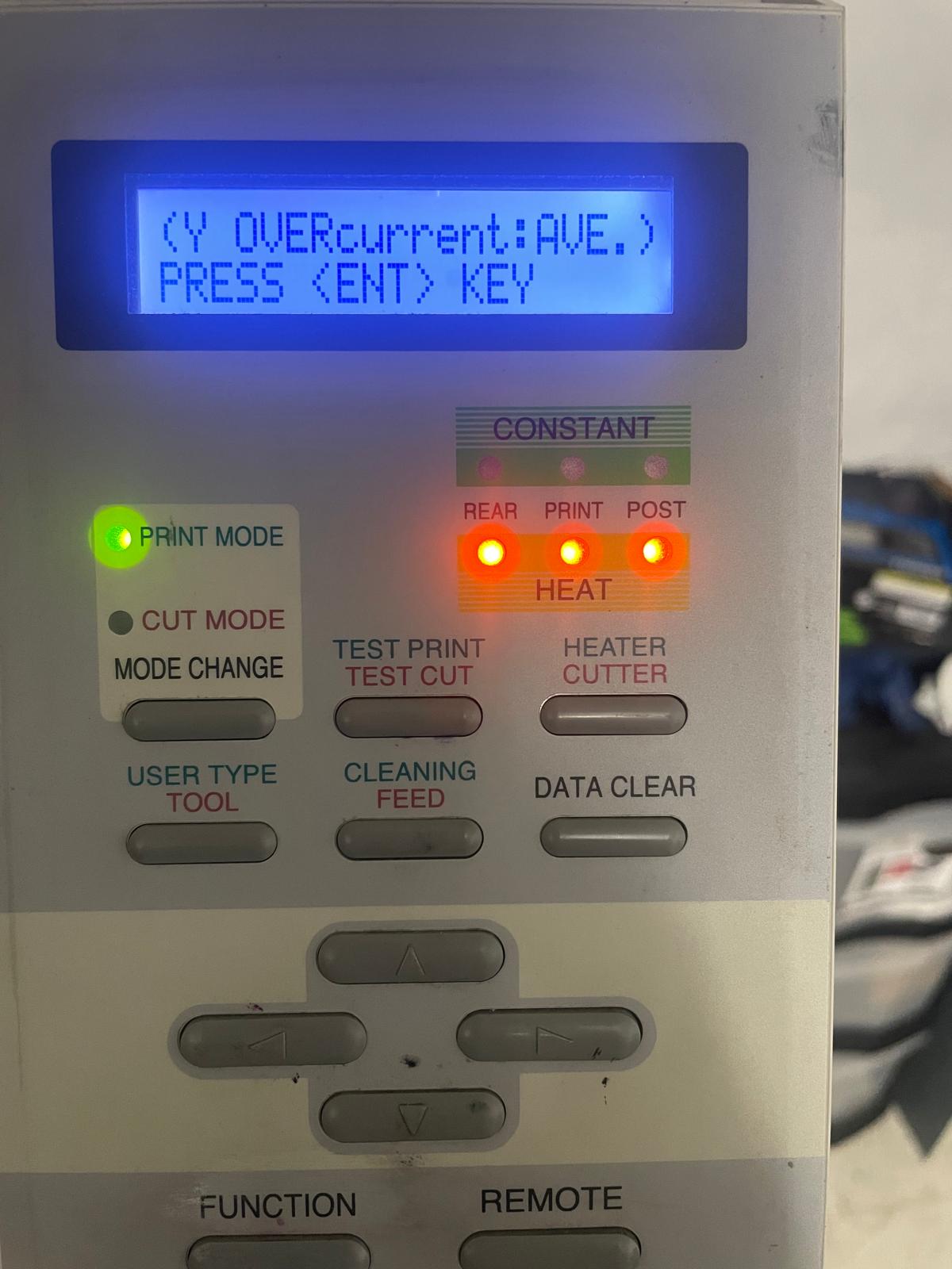

Hello all, I have a Mimaki CJV30-100 and im getting a message "y over current ave".
It will do this in the initialising stage when the cutter carriage heads back to its position on the left. sometimes it will make it past this stage but when then when I test print or try to print the same message with show up when the print head is scanning.
Ive looked online bit and some things point towards a y motor but not entirely sure. if somebody out there has had this problem or similar problem could you offer any advise. im only in my first few years of business and this is slowly destroying my life whilst this machine in sat still.
