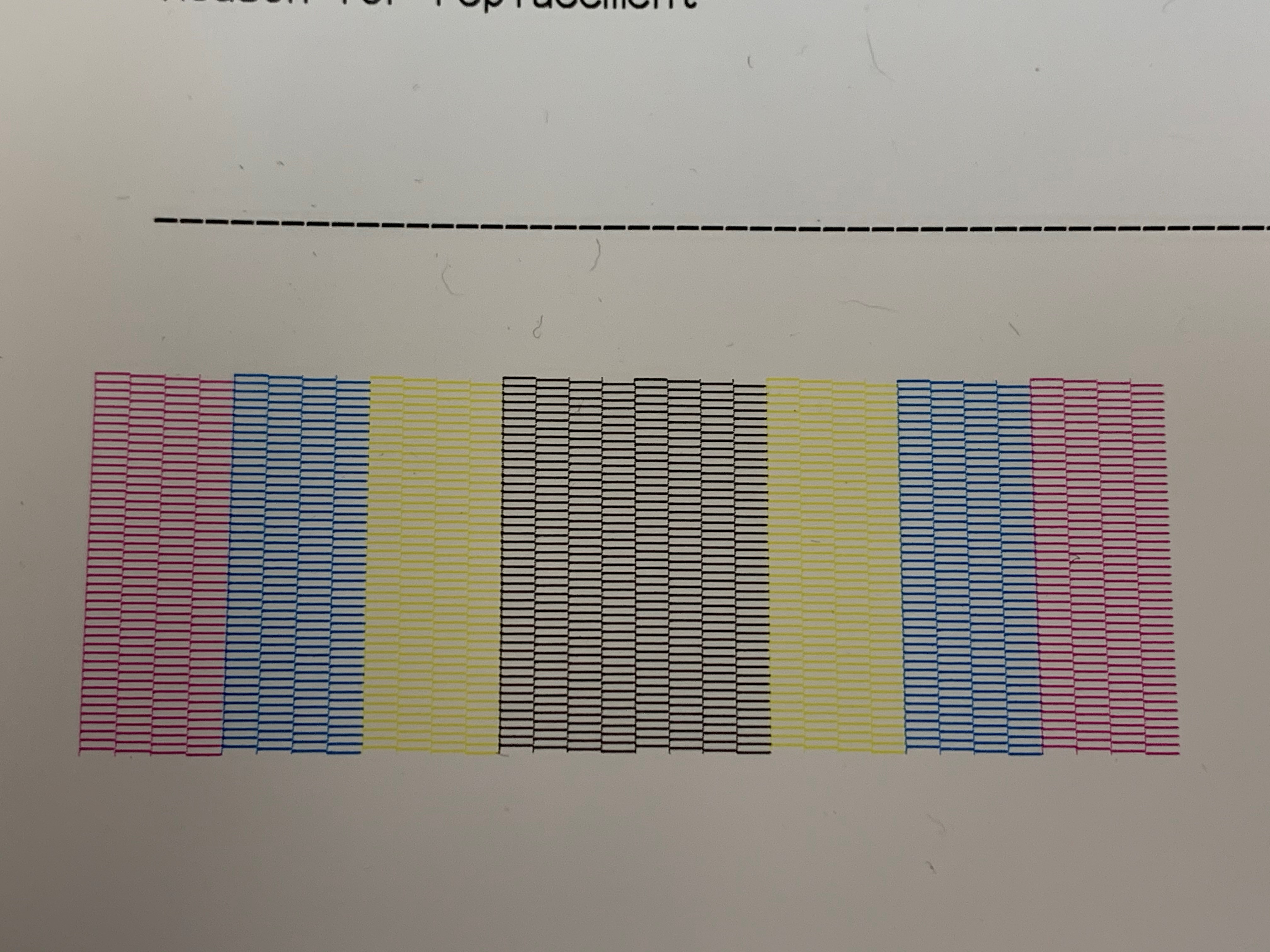

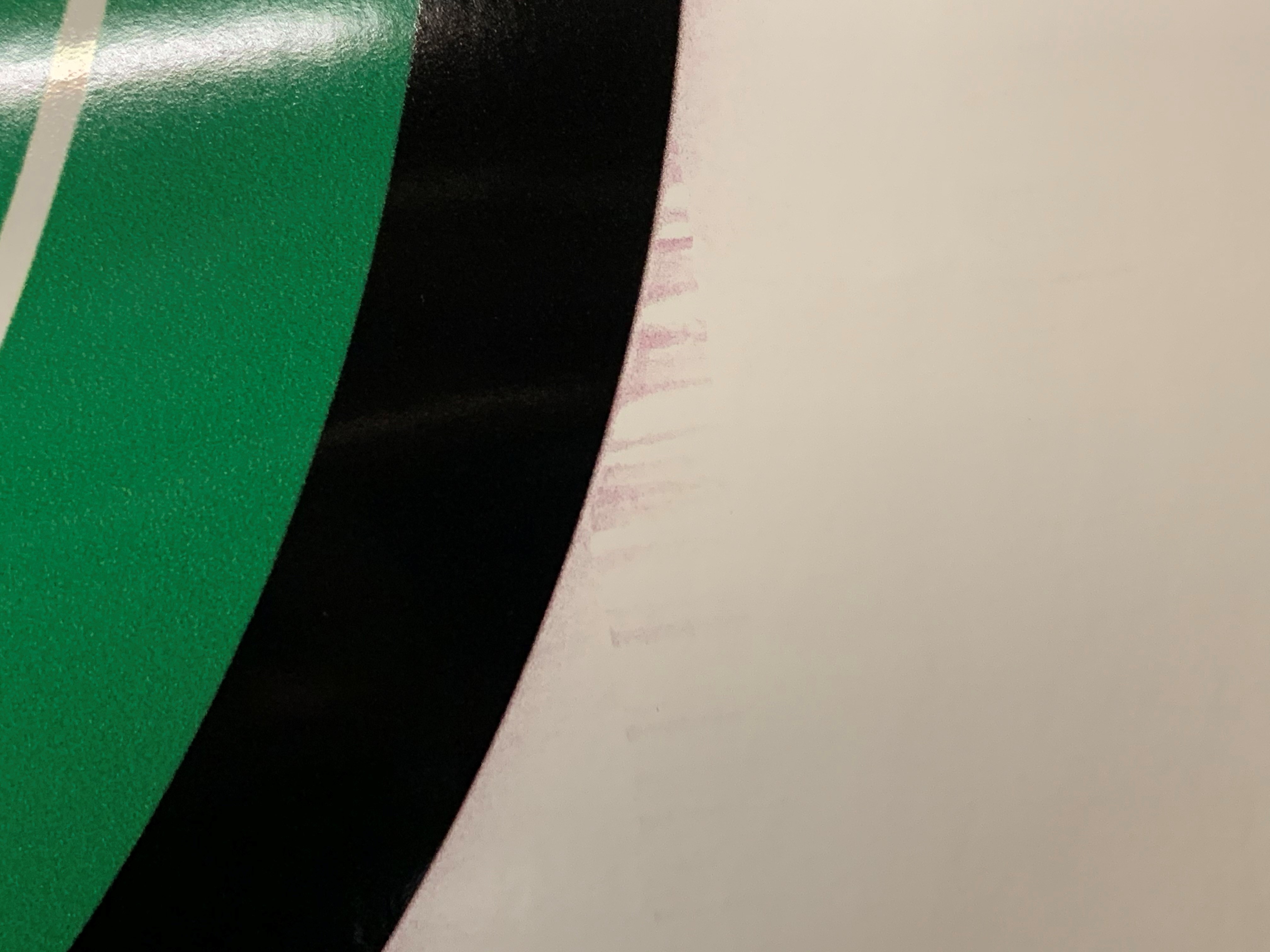

Mimaki JV150-160 Printer running ES3 Ink. Recently I have been experiencing Magenta overspray on my prints. Have performed numerous head cleanings, performed numerous Disway wash, Nozzle washes and so on. Print test look perfect. I have attached an example of what I've been getting.
Many Thanks
Murray

Capping Station is clean and in good shape same as wiper blade, and Head is clean as a whistle.
Only happens with Magenta no other colours

What you are seeing is either static induced or the magenta channel starting to fail. What is your head height? Put it in the lowest position and see if it goes away or gets better. As was asked above, does it happen on more than one media? Does it get better if you slow down the head speed?

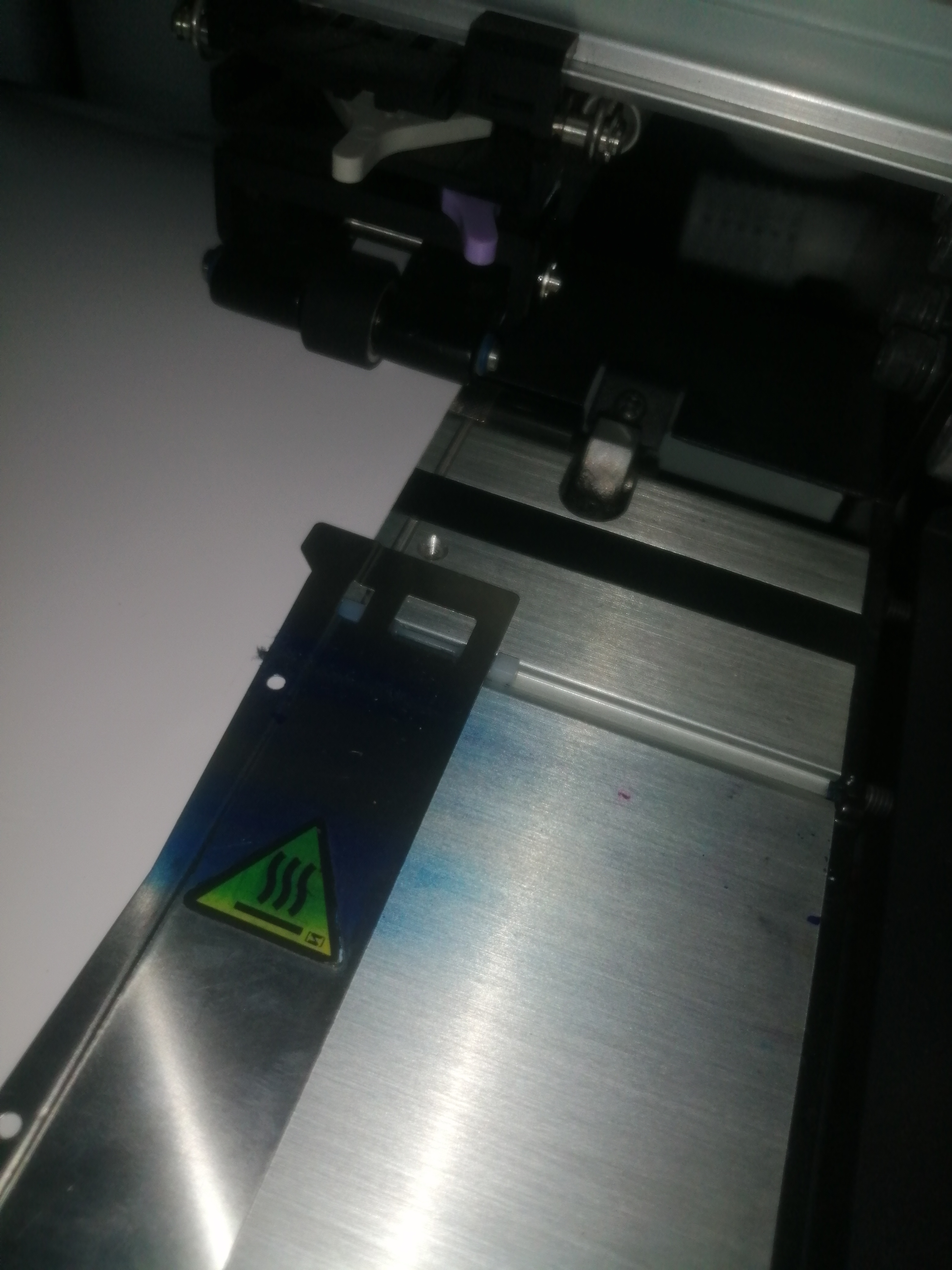

Have a cjv150-130 recently showing signs of overspray printer is 1yr and half old.... haven't changed dampers ...recently changed capping station and pump... need some help

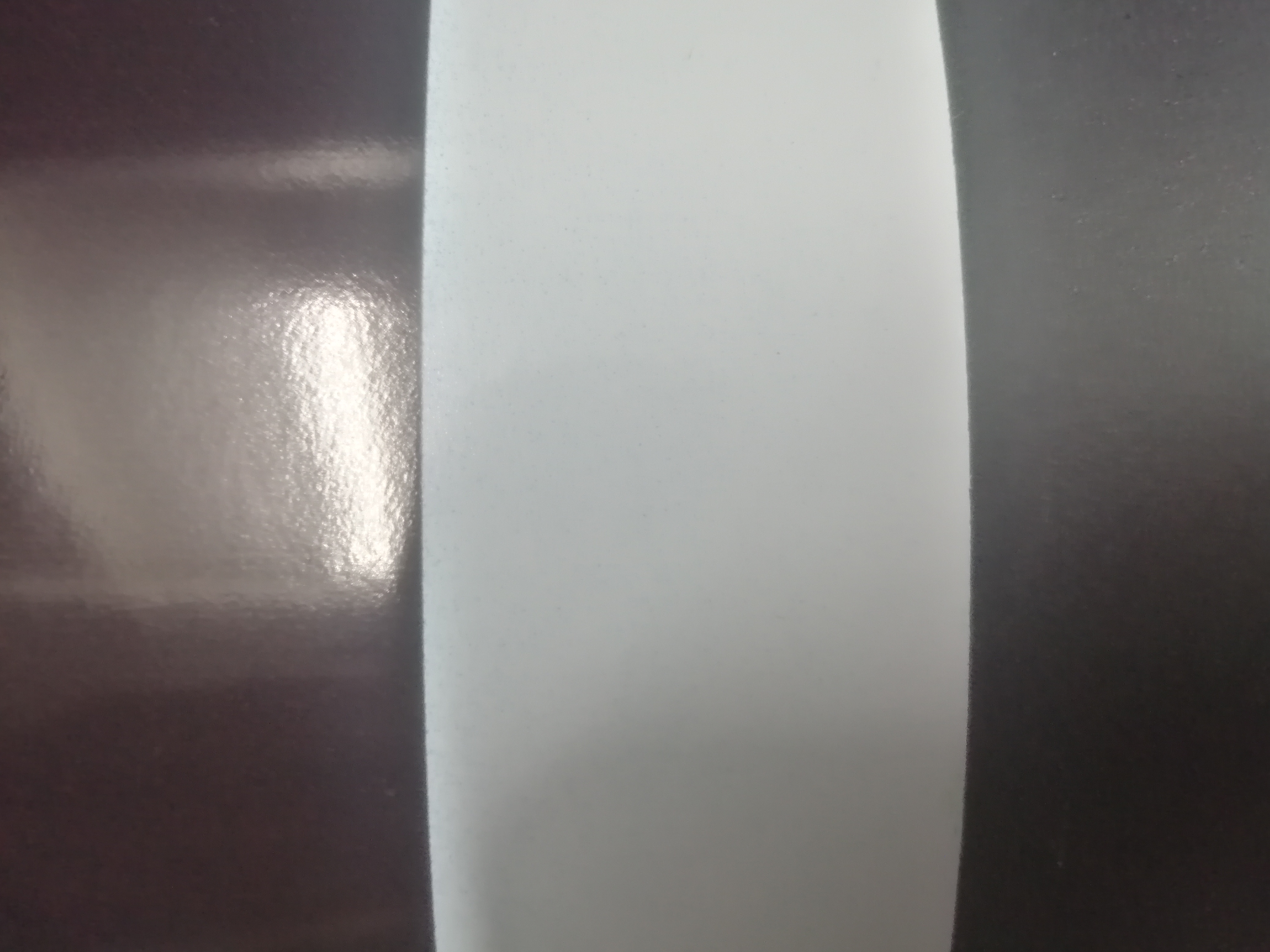

I have a CJV30 and I'm getting the exact same overspray pattern as shown in Murray's fist pic. On the capping station side of the Y axis, mostly along the right hand edge of the vinyl. Also some mini overspray like a halo all around the other 3 sides of printed color. It's the Cyan for me.
Actually, looking at it again now, it's mostly visible where the pinch rollers are, as someone mentioned above.
I think that, because it's a fine mist overspray, it probably just gets attracted to the roller tracks more easily.
It started happening a couple of weeks ago, and got worse. Only when I print blue.
