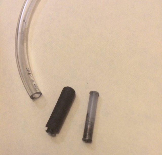

Pinch rollers for Mutoh 1204 Costs $26.00 Each you will need about 64 rollers and it will cost about
INSt
take out the old rollers
clean the rubber off keep the inner core white plastics
get your self a 3 feet 3/16 clear tubing from your local hardware store
cut them to piece slide the white plastic core in side the tubing
keep it inside the grove so it doesn't stick out
put it back together and wala :Big Laugh
