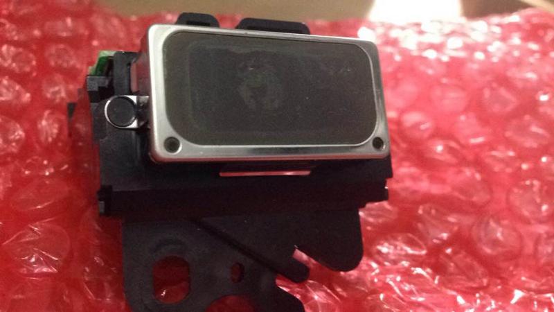

I get picture of the refurbished DX2 head nozzle from the guy, my regular supplier. (I mainly buy DX4 DX5 and DX6 head from them, not DX2 head)
They warranty to users are all nozzle fired.
They advice customers test the head early when printer heads received.
If the nozzle not fired at early testing, printer head can be replaced.
I have no experience with their DX2 head, but we trust them at DX4 DX5 and DX6 heads.
