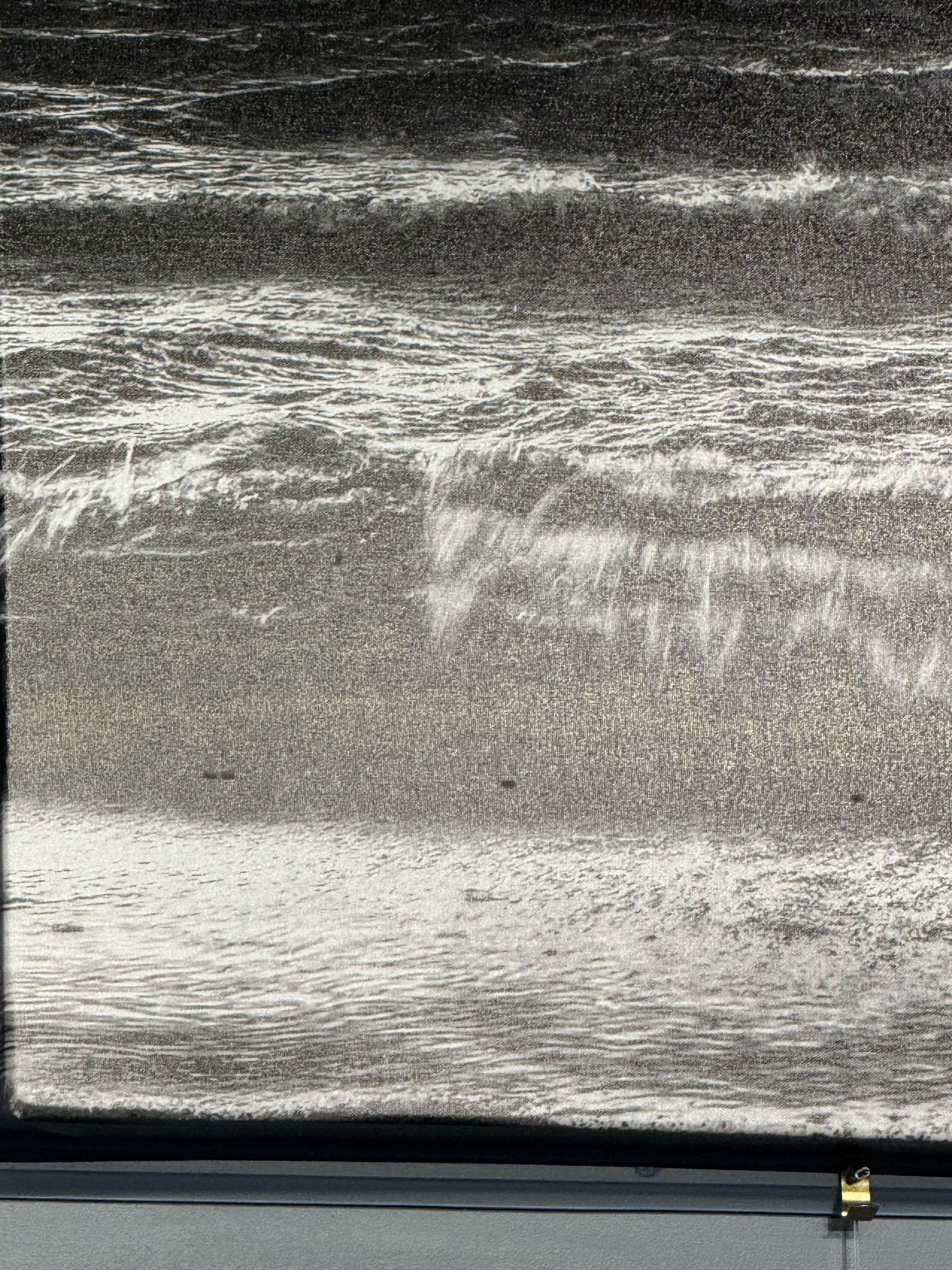

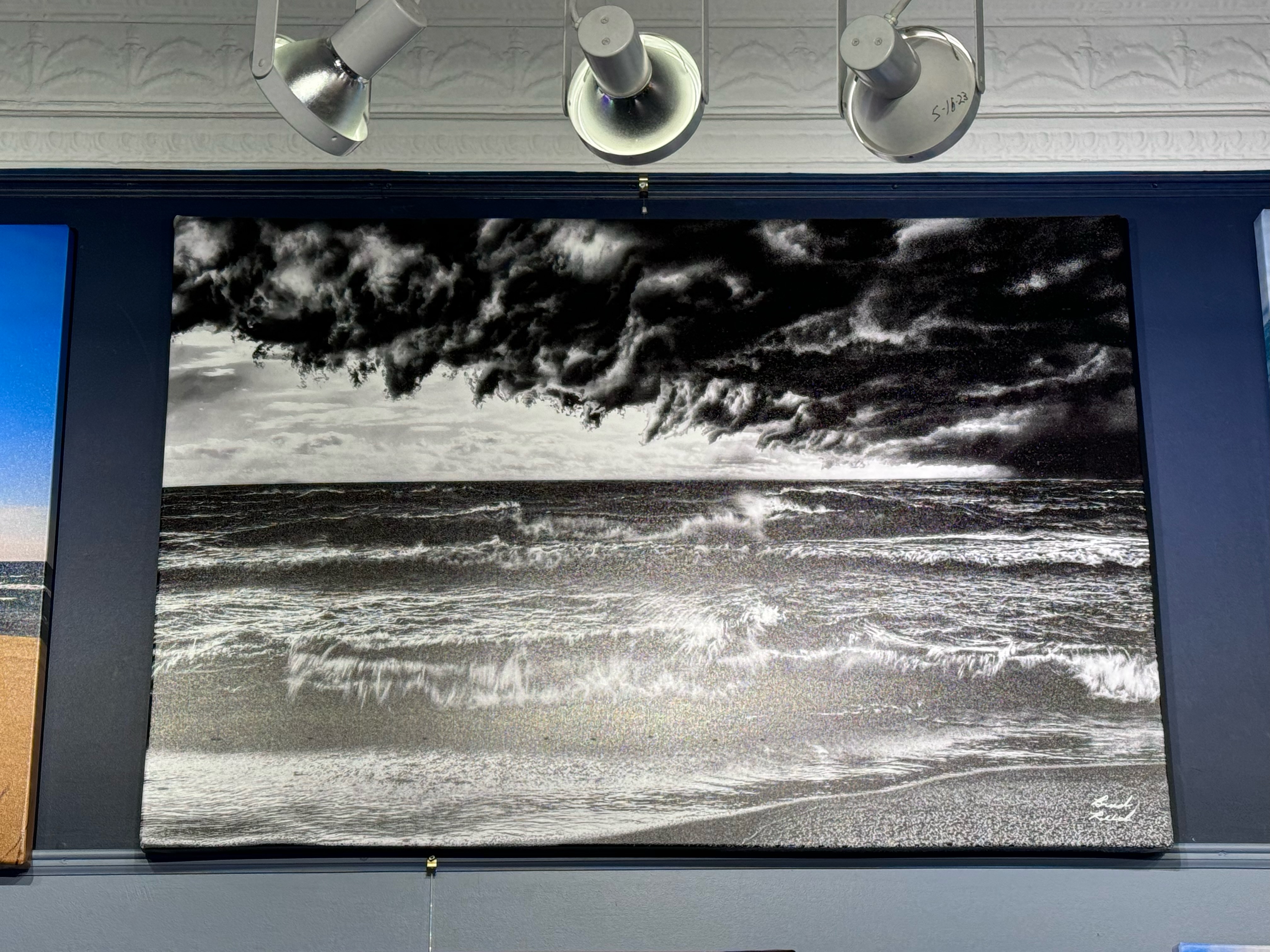

I am regularly seeing these markings on canvases printed off an Epson S80-600. I am new to the printing world and have tried head cleanings and maintenance. I am thinking these might be caused by head strikes? Any help would be appreciated.

If you're talking about the black drops, those are drops of black ink, most likely coming from a piece of thread or fuzz stuck on the print head/carriage somewhere. The fuzz collects ink mist and then drops it on the print.
77R

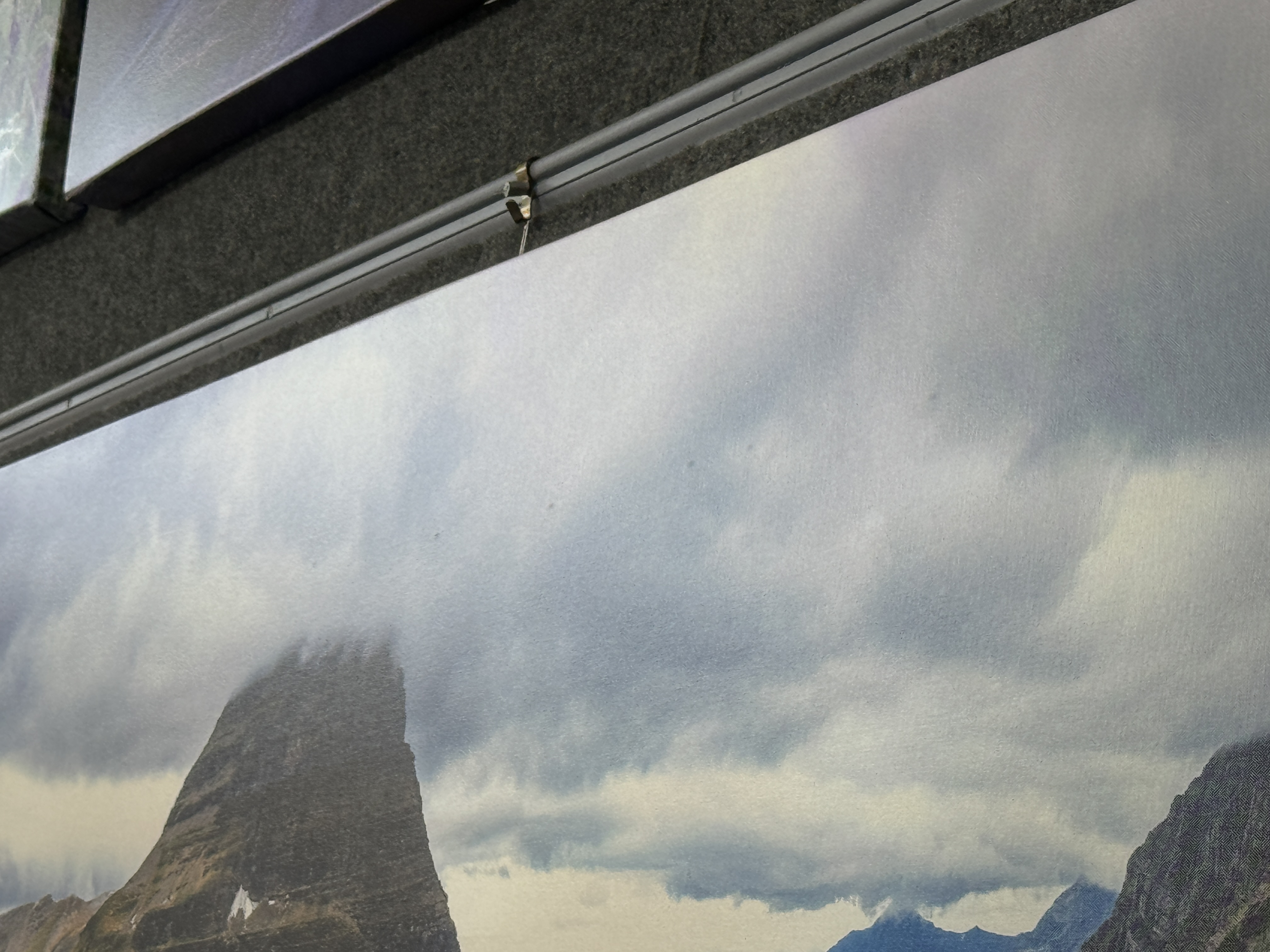

This would cause them to be in a rhythmic pattern? I did do another head maintenance yesterday looking for thread or fuzz.
