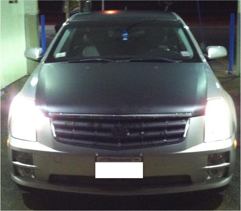

Matte black hood - roof - grille - New Cadillac STS
g&eprinting
Cotton Glove, Heat Gun, Exacto, Felt covered squeegee
Grille no problem stretched right in.
Short term promotional wrap
Oracal matte black 7125
Could crumple this into a ball and bring it back to life with a little heat.
This stuff will gloss with too much heat.
Grille is wet not glossy.

looks good from what i can see. i hope your wrapping skills are better than your picture taking skills.......you are gonna like the 970ra if you like a vinyl that has a super aggressive adhesive but goes down well overall. good luck with it.
