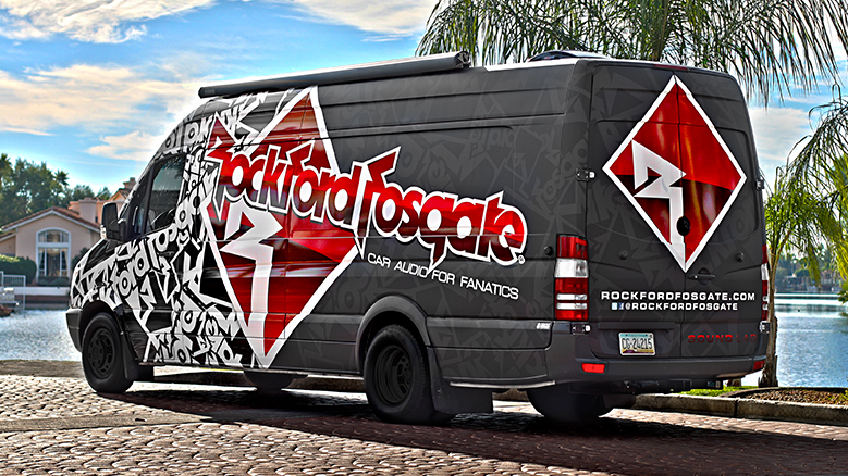

Hi there. I have a customer that is requesting a similar technique on his Sprinter.
He wants a mixture of a matter gray look (Printed) and a glossy logo on top.
I told him that the Sprinter has to be wrapped full with matte and then accent it with a contour cut logos on a top of already wrapped vehicle. They are OK with it.
I'm using Avery 1005RS and 13560DOL combo.
This would be my first time dealing with matter and I'm wondering if the only difference is matte laminate or I need to get a matte vinyl too (and if that is available)?
Thank you
Dennis422
That is a sample they found online. That is not my design (I wish it was)
I'm aiming to do something better :rock-n-roll:
Charlie J
As long as it's a cast laminate, it's all the same stuff. I believe he's just telling you not to use a calendared overlaminate.
