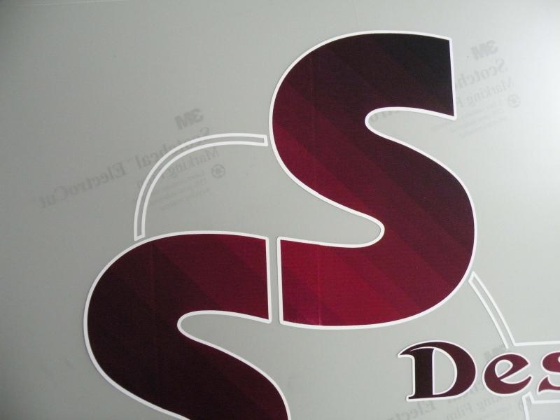

Hi folks--
We're having problems with the Maxx -- the picture below pretty well says it all. I've played around quite a bit with various halftone types/LPI's, but with a lower halftone, 40 lpi or lower, image is too coarse for something that will be viewed fairly close. With a higher (from 50 on up) lpi, it causes serious banding, and of course around 90 or so, color deterioration also.
Obviously we must specify a proper halftone because of the linear fill (it's a 45 deg. if you're wondering, thus the angled banding). I've tried both spot (burgundy & black) and process (which is definitely better) with various lpi's. I believe the one in the pic is 55 lpi. I am using Classical Dot by the way.
What is to be done?? I am at a loss as for what to do. We've printed photos on the Maxx that looked excellent at an 80lpi.
Thanks for any help anybody can give!!
