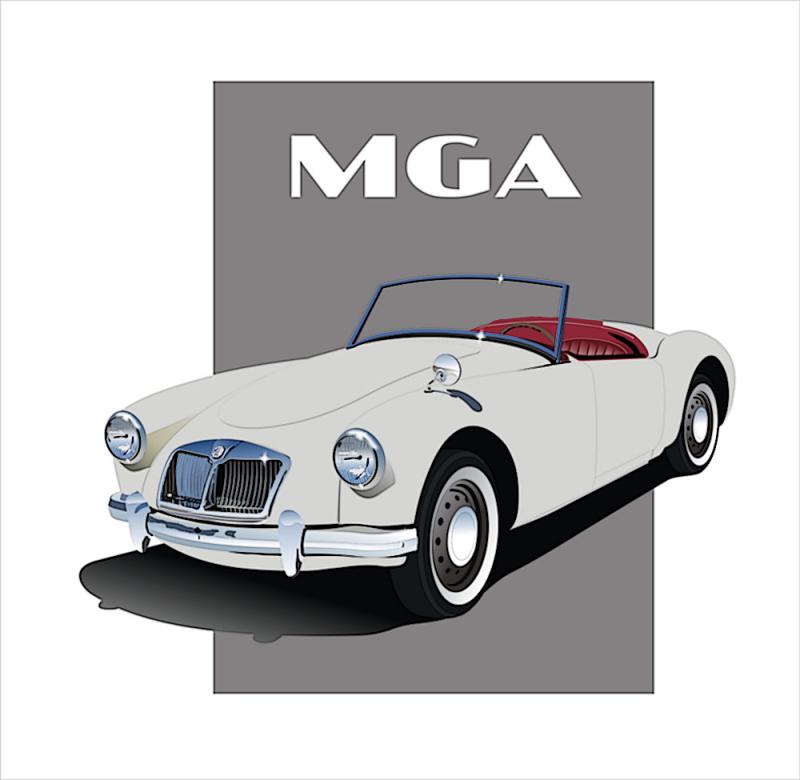

I've been having fun drawing cars the last week or so in my spare time(!) and I'd like to get this one a T shirt for the up-coming British heritage car show. Just a single shirt for myself to see if there is any interest. Will the design work for this? I know absolutely nothing about this.
I want to put it on a gray shirt. What process would work for this? Is DTG the way to go or inkjet transfer or?
Also... I'm having trouble with the front bumper and bumperettes. If anyone can tell me what to do to make them look right, that would be great.

Nice work on the drawing.
Take a second look at the shadow on the mirror - you have it going slightly to the rear of the car but the main shadow under the car is projecting out the front.

Good catch on the mirror shadow. I fudged the shadow under the car and forgot about the mirror.
