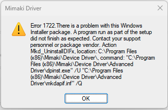

Attached is an error message I get when installing or removing the driver

I believe it has something to do with the driver not being compatible with the newer ARMS on windows and Mac . (used the latest driver)

There is not a working Mimaki ARM driver to my knowledge, just X86 32/64bit drivers. Might be different in the future, but the lumbering Japanese dinosaurs can move slowly at times.
