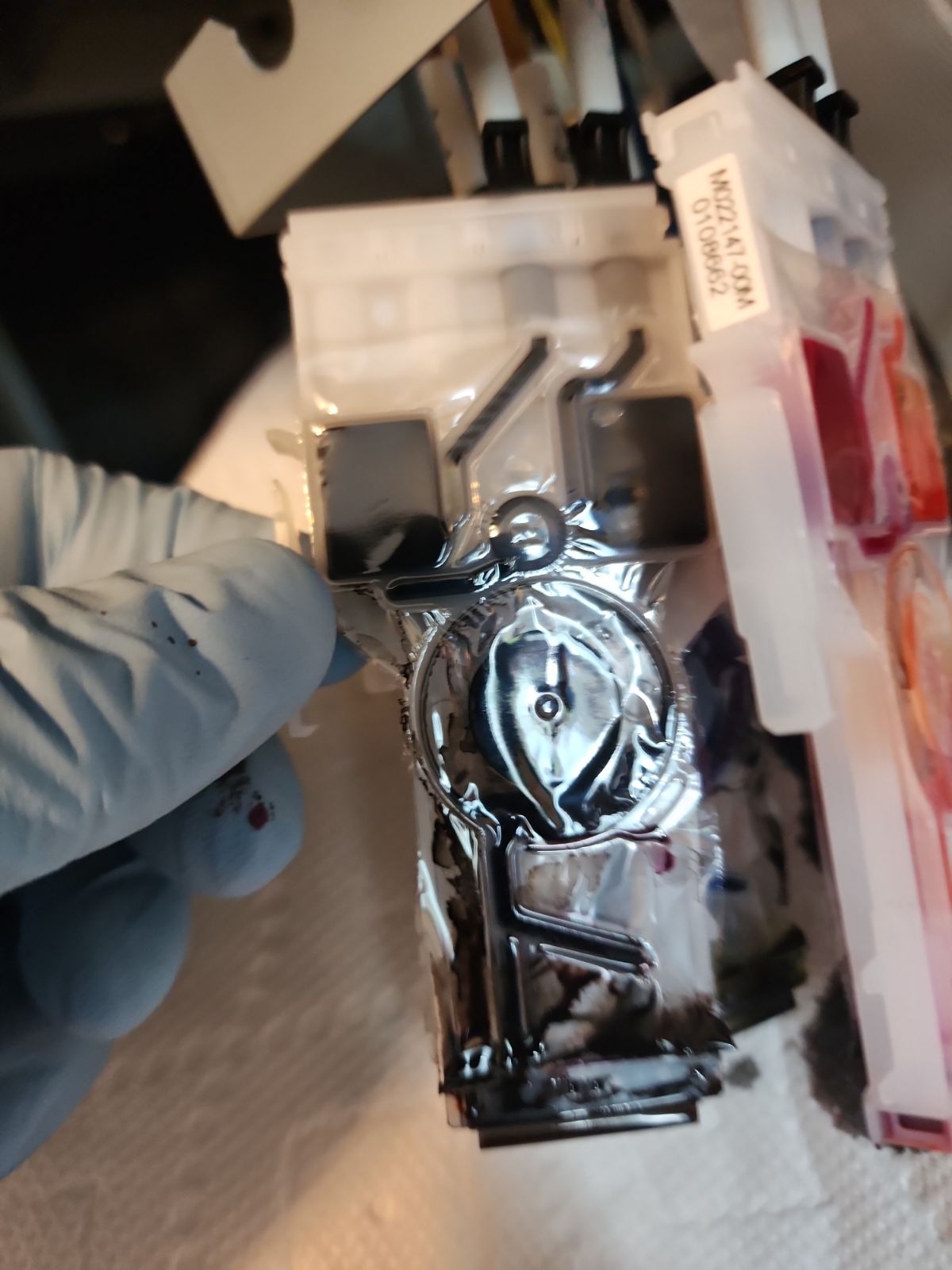

Yesterday I did a bunch of cleanings, ink fills, and removed the dampers in hopes of agitating something to get my printhead back, but it did the opposite. Now I have nothing.
When I push on the dampers ink will drip out, so I can assume from the cartridges to the dampers is OK?

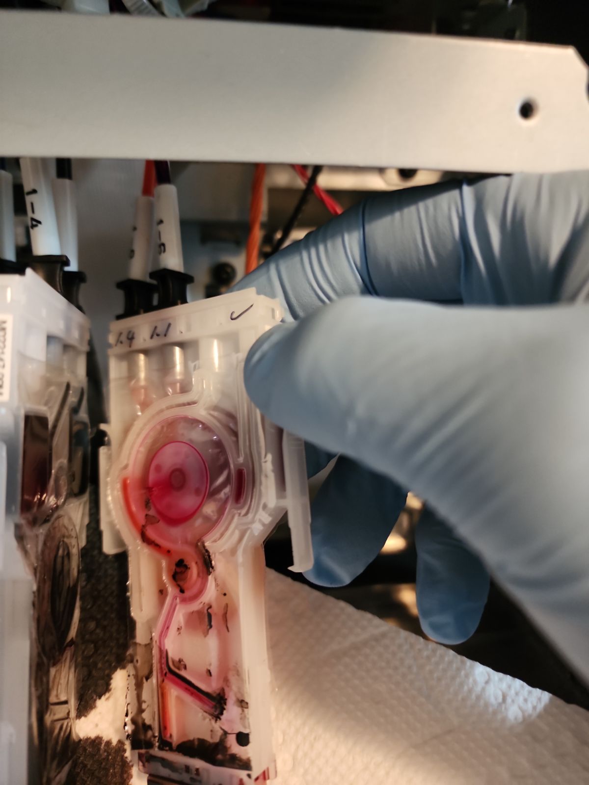

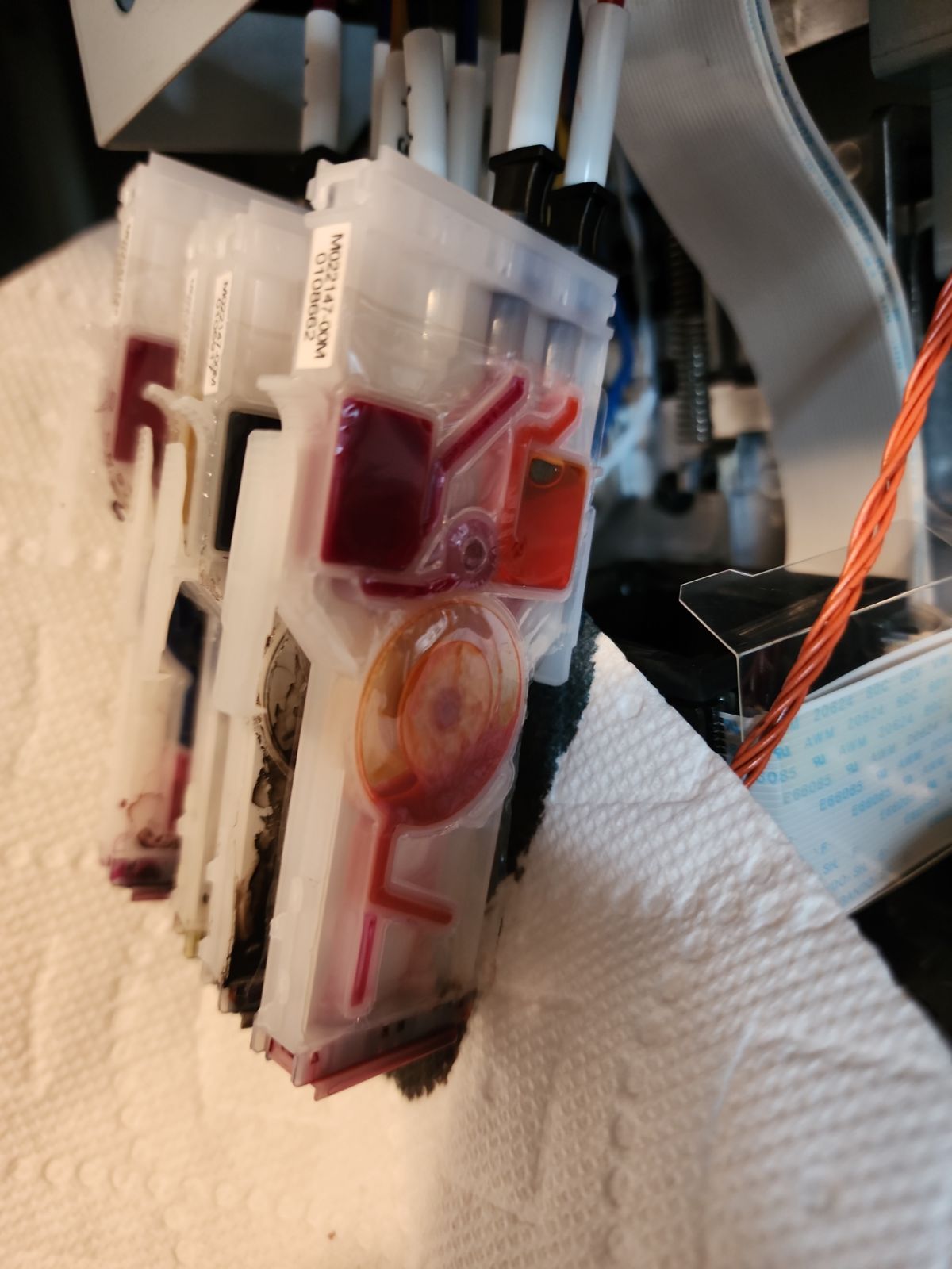

So I was able to get some nozzles back. I noticed the orange line from the damper looks much more transparent compared to the line from the solenoid. About 6 inches back from the damper is transparent.
I removed the dampers again and noticed some weren't even filled all the way. What are the chances on the ink drying up in the damper?

The dampers being empty needs to be addressed. It may be due to a bad seal at the cap top allowing air in and losing prime/pressure in the ink line.
To pull ink back into the dampers (on my CJV30) I go into menu/test/cartridge valve to open the valves to let ink flow through the lines.
Then I put a syringe into the damper bottom (where it plugs into the head), INVERT the damper so the bottom point up, so no air pockets get trapped.
Pull the ink through to fill the damper. Clean around the nipple and plug back in. Close the corresponding valve.
Fill them all then do a cleaning. take note if any ink pools in the cap top.
If not its either because all your nozzles are blocked (unlikely), or the cap isn't making air tight seal (probably), or the tubes underneath are either blocked or letting air in.
When you plugged the bottom tubes into the cap top, did they fit tight?
They need to be dry to push firmly onto the small cap nipples. And there's that 3rd hole....

Have they already been compromised? These dampers have been removed 3-4 times now.
netsol
with a magnifier you can see the hairline cracks,
take a magnifier and a BRIGHT light
be very scrupulous about ink splashes, though!
