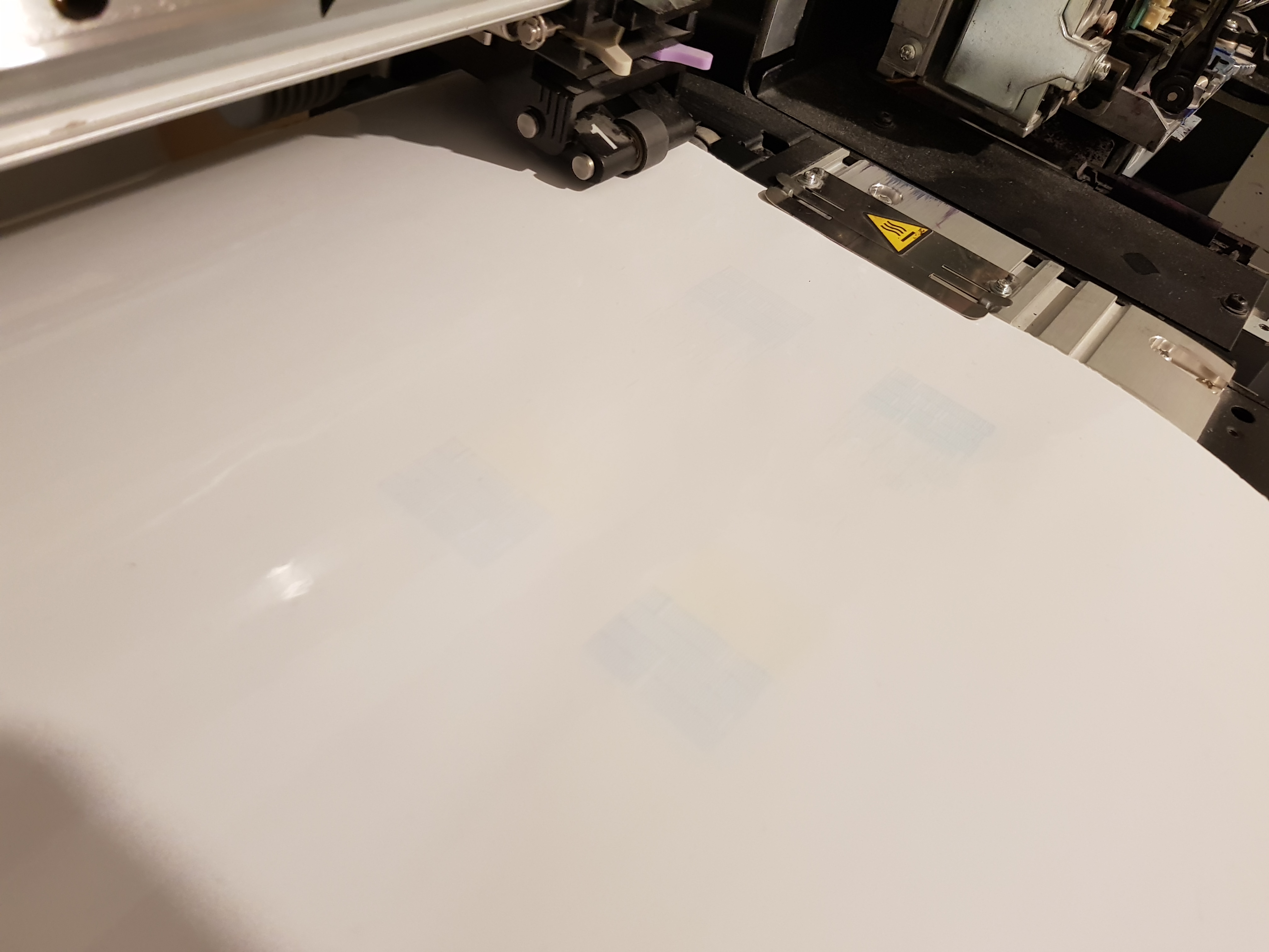

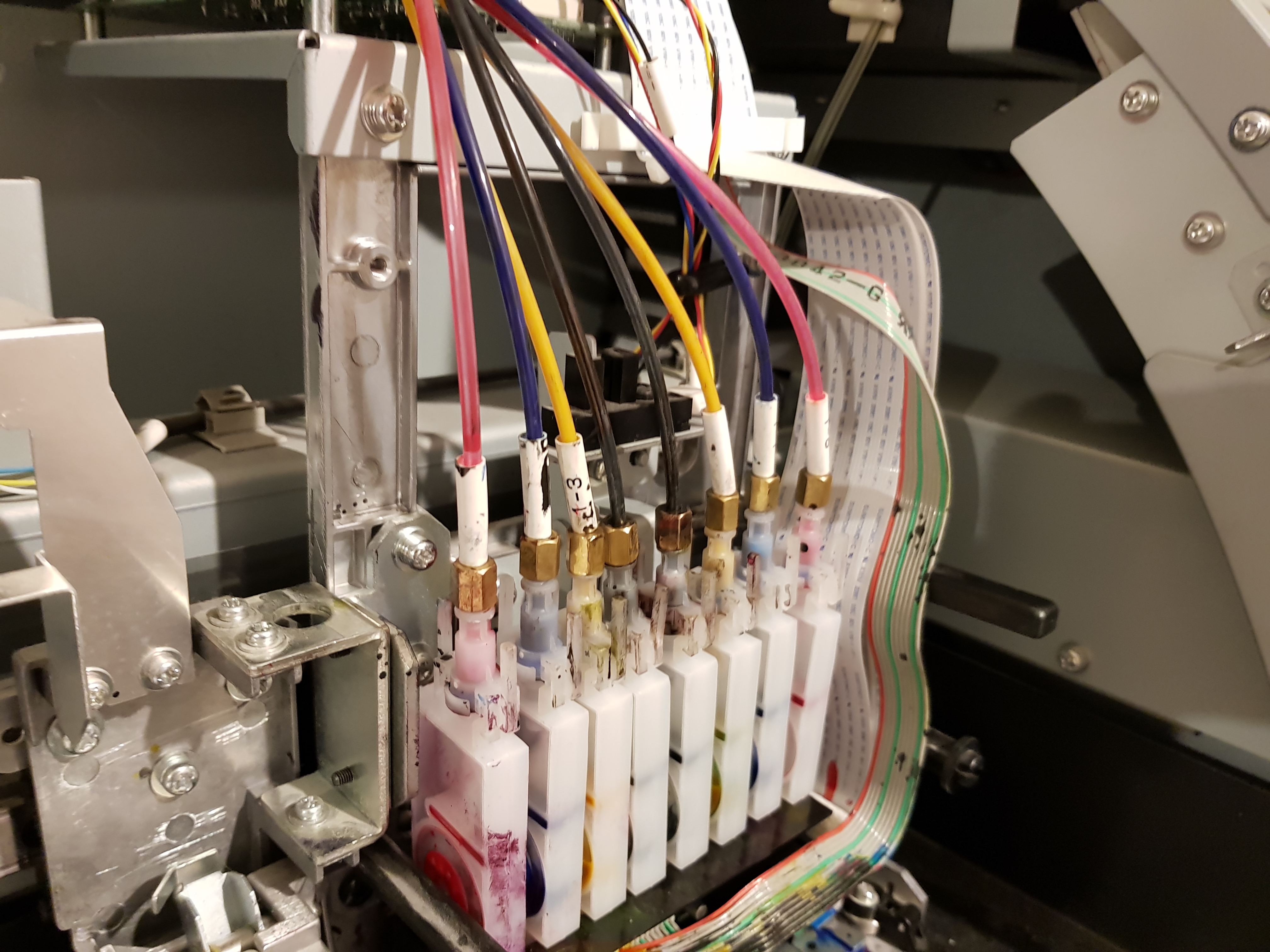

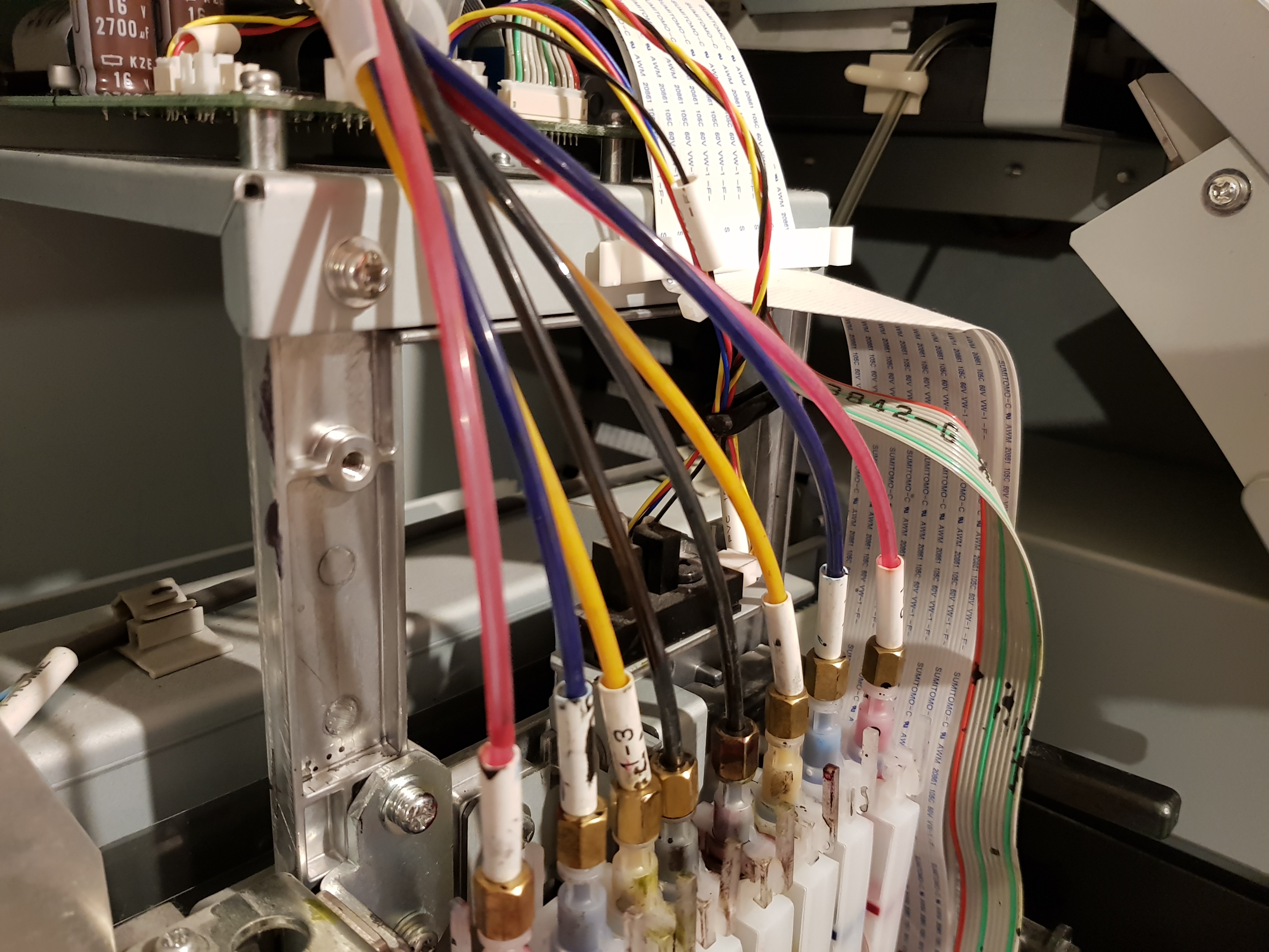

My Mimaki CJV30-60 was left sitting idle for a whole year. The nozzles were working perfectly before then.
So I recently changed the dampers, tubes and capping station. I also gave the printhead an overnight soak. I went into options and selected Ink Fill Up. Still nothing was coming out of the test prints. So I decided to manually try and fill up the dampers. I took a syringe to the damper nozzle and tried to slowly pull on the syringe to extract ink into the damper. I did this with a 10ml syringe as I don't have a bigger one. The ink will then just flow back to the opposite direction as if there's pressure pulling it back.
Next I decided to pull ink through the waste ink tanks tubes under the capping station. There are two tubes so I used the same syringe method but instead plugging up one tube and syringing the other. This seemed to have drawn ink from one of the yellow tubes as well as one cyan tube.
After this I did the ink fill up which now seems to be pumping ink from the yellow and cyan tube but nothing else. As you can see from the photos the nozzle tests show that there's some success in bringing back those colours. The other photos show that the rest of the lines are clear with no ink flow.
What is the next step for me to bring back the rest as it seems that the ink is still trying to flow away from the rest of the dampers. Did I do the right thing by sucking ink through those waste ink tank tubes or is there another tube I can suck it through? Any help is appreciated. Thanks
