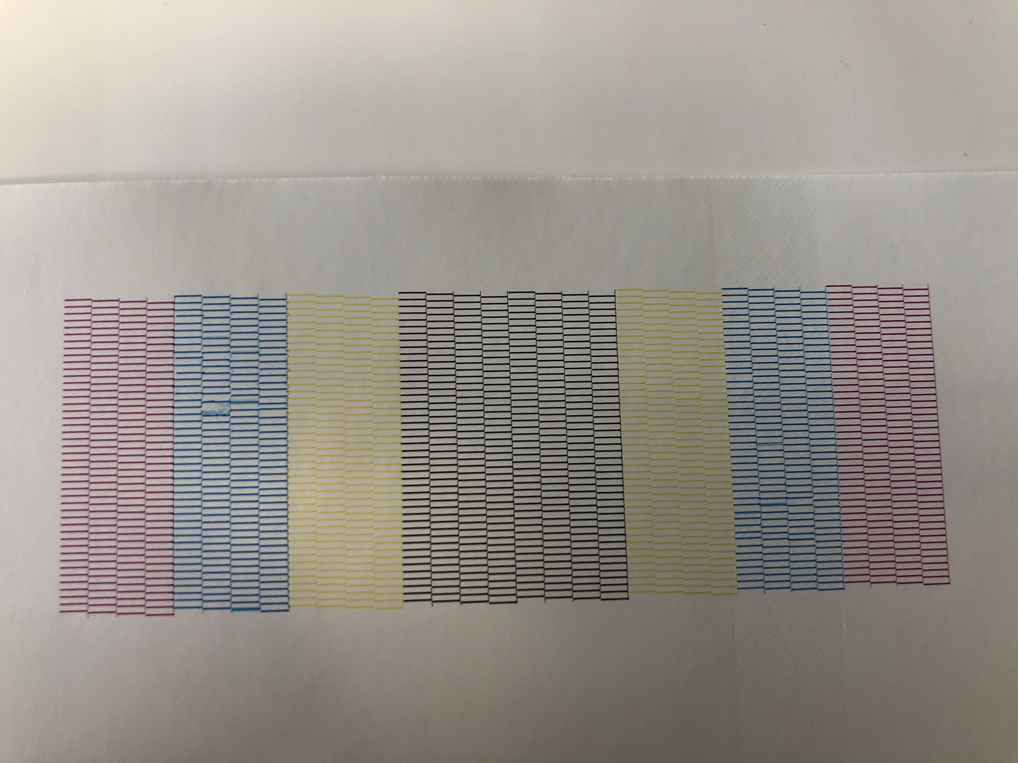

Hi I have noticed the cyan nozzles have become slightly deflected and I am wondering if this is something I should be concerned about? The machine is 2 years old and has had the following work on it done
Cap Top Replaced 6 Months Ago
Wiper 2 weeks ago
Pump still on Original never replaced
Dampers still on Original never replaced
Would love help with this one as I am stuck and cannot get them to come back. Left to soak overnight with no luck.
Thank You

Try a nozzle wash and gently wiping the face of the head with lent free cloth and cleaning solution, only one way (do not rub).
I wouldn't be concern at this time but I would consider replacing the dampers as they should be replaced every year to keep the printer in good shape.

I have left the machine to soak again today and will see how it looks in the morning. I did get it a whip with a lint free cloth the other day which helped a little bit. A part of me thinks its potentially dampers starting to fail. I know there isn't a full colour drop out but its with both doing the same.

Normally dampers wouldn't cause deflection, despite I recommend to replace them no matter what as they are 2 years old.

You may want to verify that there is no damage to the face of the print head. Also, run a normal cleaning and make sure the wiper is making good contact with the head during the wipe process.

If you've tried all of the above and the same nozzles are still deflecting we call that a hard out. Have you tried increasing the passes 12, 16? If you can't live with the Prints you may have to replace the printhead.

I am happy with the quality of the prints I was just concerned as it only seems to be cyan with deflections. I have since replaced the Pump and Captop which hasn't made a difference. I can live with it just strange why cyan only seems to be affected. I cannot see any noticeable damage to the head.
